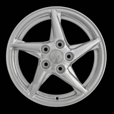

csrMark Posted September 15, 2010 Author Report Posted September 15, 2010 WILL THESE FIT? A WRECKER HAS A SET OF 4 OF THESE IN MINT SHAPE ON A GRAND PRIX. I don't know the year but the 4th digit of the vin has a "W" They aren't polished but are 16" and come with rubber in great shape. He wants $300 for everything? too much????? or good deal? will they fit ? Quote
csrMark Posted September 15, 2010 Author Report Posted September 15, 2010 any 1st/1.5 gen W wheels will fit and have proper offset(the x-laces are a bit too wide though?). WILL THESE FIT? A WRECKER HAS A SET OF 4 OF THESE IN MINT SHAPE ON A GRAND PRIX. I don't know the year but the 4th digit of the vin has a "W" They aren't polished but are 16" and come with rubber in great shape. He wants $300 for everything? too much????? or good deal? will they fit ? Quote
WhatTheFehl Posted September 15, 2010 Report Posted September 15, 2010 The backspacing is wrong, so no. Not without spacers. Quote
csrMark Posted September 15, 2010 Author Report Posted September 15, 2010 Hmmmmm, Is it a big deal to put in a spacer? Are they expensive? Quote
Twenty Posted September 15, 2010 Report Posted September 15, 2010 Hmmmmm, Is it a big deal to put in a spacer? Are they expensive? They're actually pretty inexpensive. Just pull the wheel off, and slide the space on the studs, then put the wheel back. If you go with really wide spacers though, you'll need either longer studs, or bolt-on pieces. I plan to run some small spacers when I get new wheels, they're a quick and handy fix for poor offsets. Quote

csrMark Posted September 15, 2010 Author Report Posted September 15, 2010 The backspacing is wrong, so no. Not without spacers. How much of a spacer would I need? I don't mind putting in a small spacer but i don't want to get into changing to longer studs, etc. Quote
AL Posted September 15, 2010 Report Posted September 15, 2010 If you dont want to change the studs, then stick to a first gen wheel... The wheels you posted interest in are a second gen grand prix wheel... Look for: 90-00 Lumina 95-99 Monte Carlo 88-96 Grand Prix 88-97 Cutlass Supreme Quote

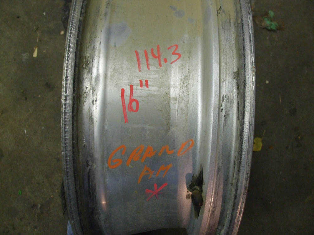

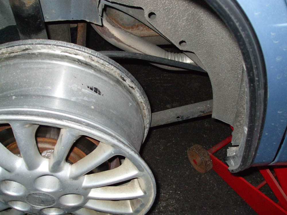

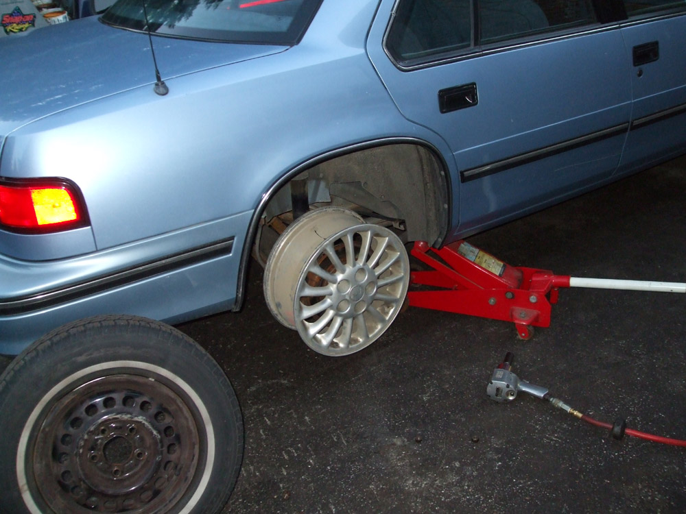

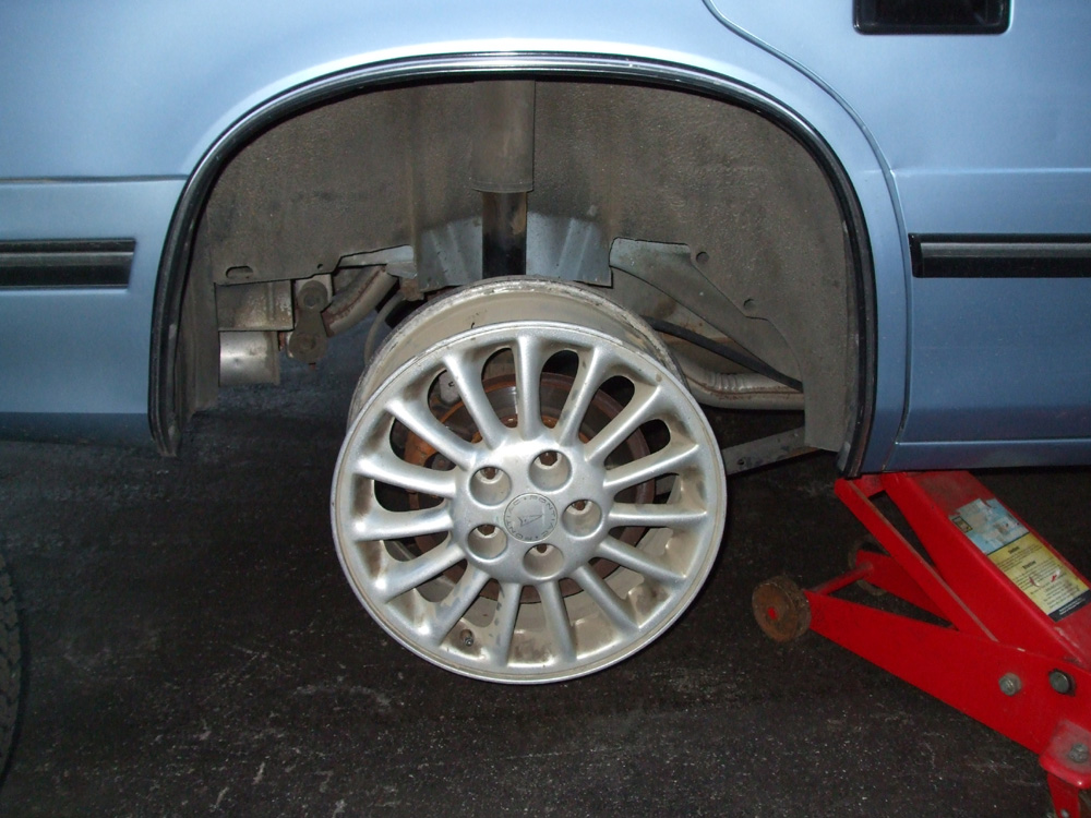

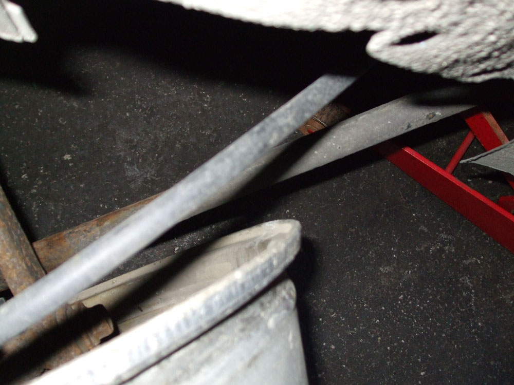

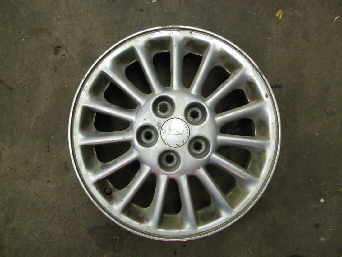

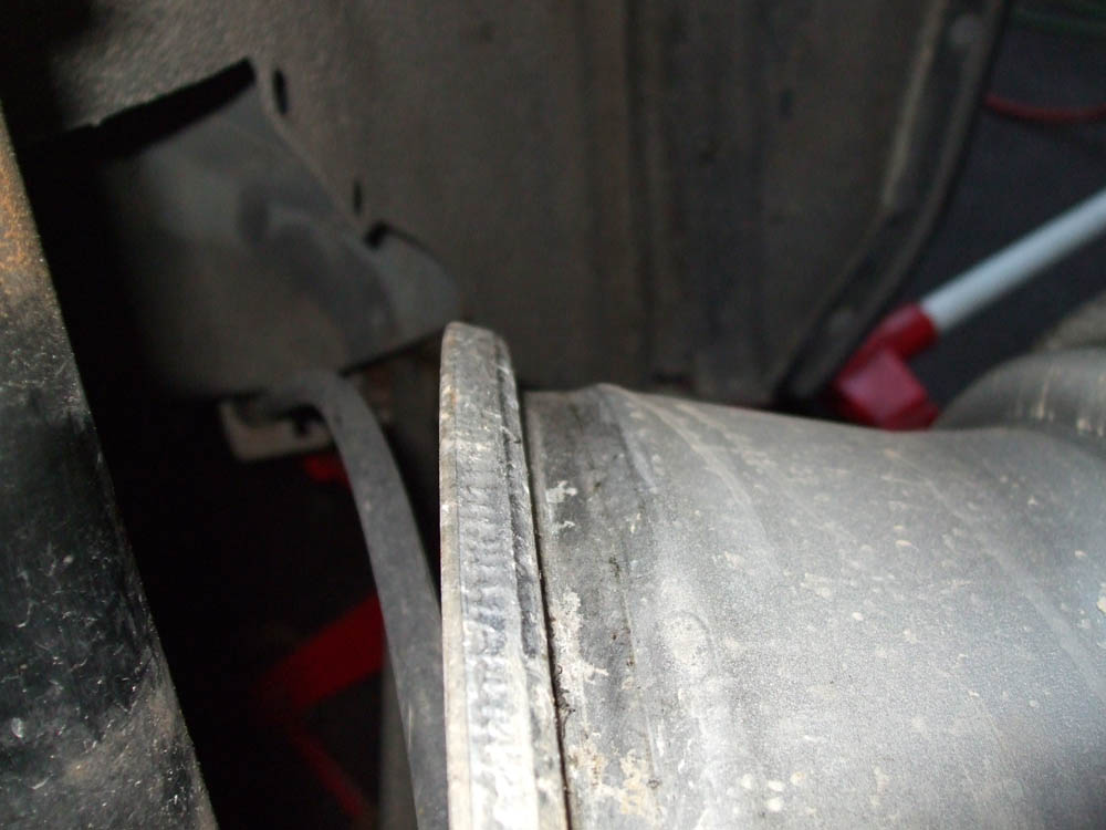

csrMark Posted September 20, 2010 Author Report Posted September 20, 2010 (edited) I picked up these . Haven't paid for them yet. PONTIAC GRAND AM rims and took one home to see if it fit on the 91 Lumina. Unfortunately, there is no tire on them. They seemed to fit with nothing rubbing They do however seem to sit fairly deep in the body of the car. Does anyone think there might be a problem once a tire is installed? OPinions please. From what I could find on the internet, they came off a 2001 Grand Am. thanks again. Mark Edited September 20, 2010 by csrMark Quote
Twenty Posted September 20, 2010 Report Posted September 20, 2010 Just run a slightly narrower tire and you should be okay. If that rubs, then a small spacer wouldn't hurt. Quote
mra32 Posted September 20, 2010 Report Posted September 20, 2010 IMO those wheels look pretty terrible on a lumina. I did some test fitting in the junkyard and they sucked. I was all for getting them too since they had tires that I liked on them. Quote
mra32 Posted September 21, 2010 Report Posted September 21, 2010 if youre still getting them i would also test fit on the front and make sure it clears everything. Youre probably right that they are likely a little sunken in, but as long as the whees clears, the tire should clear too Quote
LuminaPower92 Posted September 22, 2010 Report Posted September 22, 2010 (edited) Arent GA wheels 5x100? Mark - The silver Lumi wheels are from a TGP, that i had powdercoated silver and black. The white lumina wheels are Motegi Mr4's 5x114.3 which i had to shave the caliper bracket and put a small spacer. They are on my cutty vert now. Edited September 22, 2010 by LuminaPower92 Quote
mra32 Posted September 22, 2010 Report Posted September 22, 2010 the later n-bodies switched to 5x115. I suppose gm thought they gained a little too much weight to be running 'size small' lug patterns. i remember a pic of a GA with gold x-laces on it too. looked ok...but its still a grand am Quote
RareGMFan Posted September 22, 2010 Report Posted September 22, 2010 The fronts are the bigger issue as far as offset goes on Gen Is. I would definitely test fit a wheel on the front for clearance first as mentioned. Quote
AL Posted September 26, 2010 Report Posted September 26, 2010 You will most likely have issues on the front because the GA wheels after 99 are the same dimensions as the 2nd gen w-bodies... And there are issues with clearing the brake caliper on the front when using a second gen wheel on a first gen Quote
