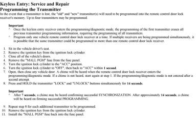

also i tried searching but cannot find a thread on how to program a keyless entry remote for this car, i can find first gen write ups but nothing for second gens. ( i got an extra remote from another 97 gp)
Well the coolant, and washer level are likley dirty sensors, its very common. And for the key fob, a quick stroll in search land will do wonders. I know there's a link on this site because i used it to do mine. Somthing like put the key in and out 3 times then hold the lock button, i can't remember.
