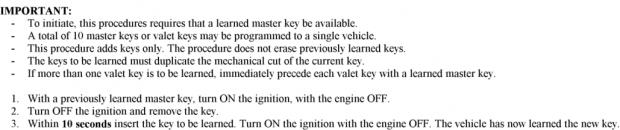

jeremy Posted August 27, 2010 Author Report Posted August 27, 2010 try this one... that's the one I tried....and I get the "starting is disable becasue of security" message on my Info Center.....I am starting to believe that the key is garbage.... Quote
