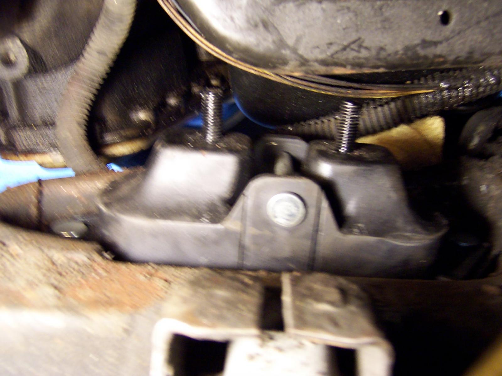

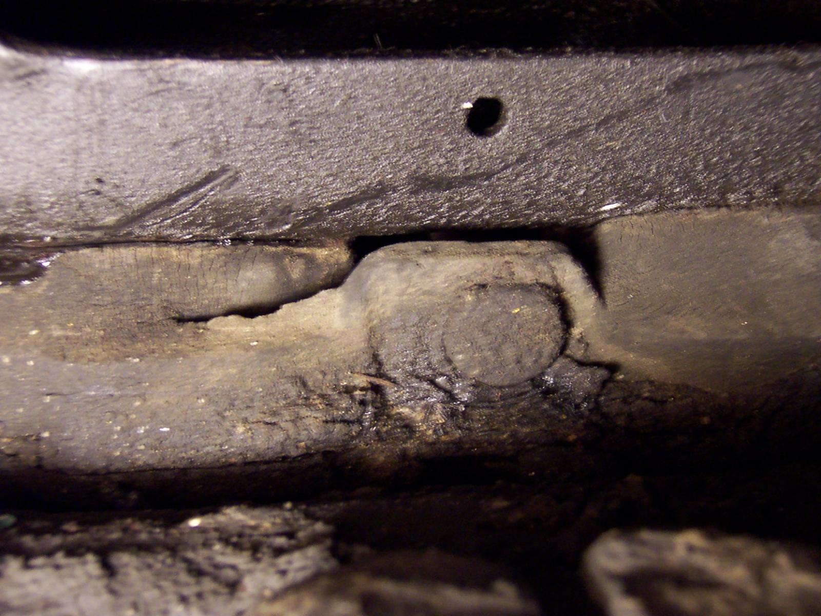

cutlassman Posted December 14, 2010 Author Report Posted December 14, 2010 I just wanted to follow-up for anyone that comes across this post and has the same problem. Thanks for the replies - you guys were right. I finally got around to replacing the lower engine mount. You can see the OE fluid-filled mount on the car was completely trashed. I went with the fluid-filled replacement. Raising the engine enough to get the old mount out and new one in is a PITA. I had to loosen the heater hose that runs along the passenger's side wheel well because it was stretching too much. Getting the engine bracket back over the new mount bolts was a serious challenge. Box end wrenches are a must for the top two nuts on the mount. The end result is perfect! The nasty clunk is gone and the shift to reverse from park is nice and soft! Now, on to the next project... Quote
