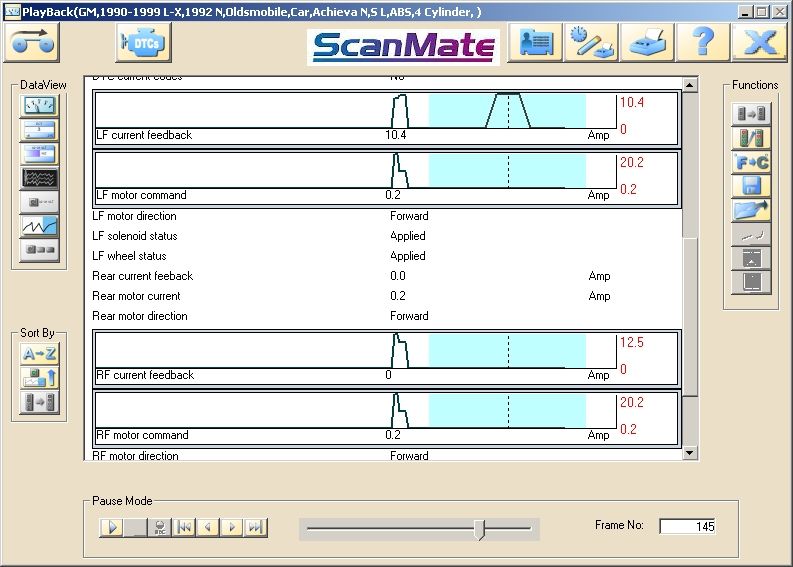

Cutlass350 Posted August 15, 2010 Report Posted August 15, 2010 (edited) BTW: Below is a capture of the error that my Delco-IV ABS system was detecting during it's power-on self-test, and then disabling over: Note that the LF (Left Front) current feedback sensor reported current, even though the the LF motor was not commanded. Edited August 15, 2010 by Cutlass350 Quote
