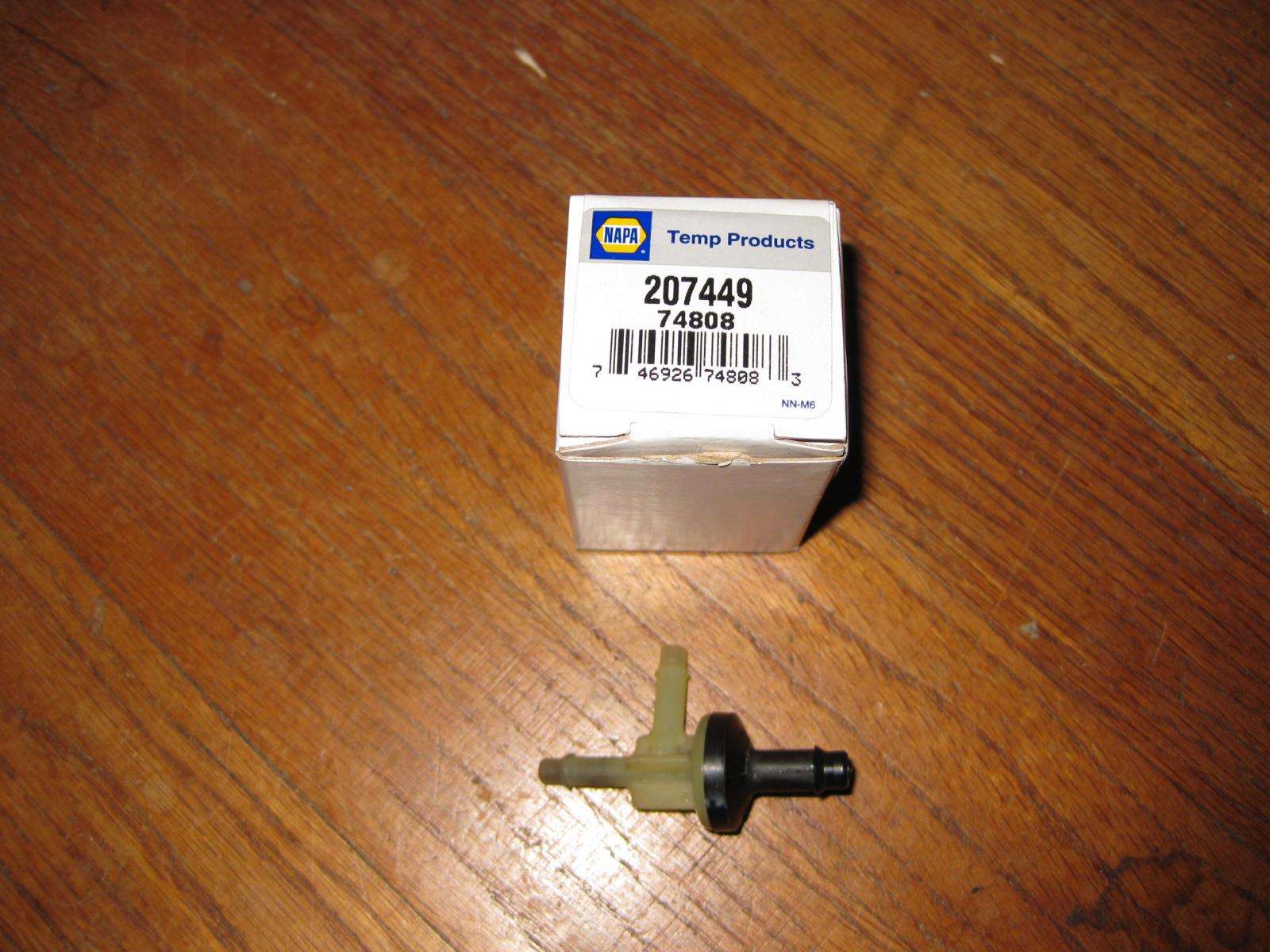

chrisflstf Posted August 28, 2010 Report Posted August 28, 2010 Got mine at Napa. P/N 207449 Pic of the old valve and new part box. Black end goes to the intake manifold Quote
Highmilagecutlass Posted August 28, 2010 Author Report Posted August 28, 2010 Got mine at Napa. P/N 207449 Pic of the old valve and new part box. Black end goes to the intake manifold Thanks Again ! Nice picture Quote
