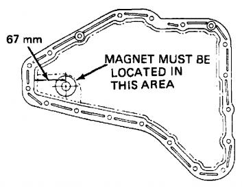

RobertISaar Posted August 8, 2010 Report Posted August 8, 2010 magnet is a good idea. you're supposed to keep it in a specific area of the pan though. Quote
tornado_735 Posted August 8, 2010 Report Posted August 8, 2010 Yea there should already be a magnet in the pan. There was one in both of the 60's I've dropped the pans on. Quote
