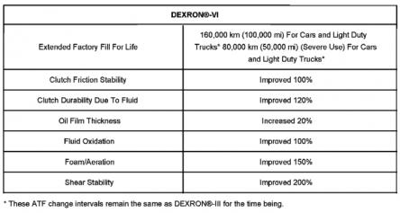

RobertISaar Posted August 6, 2010 Report Posted August 6, 2010 330K? i would go with Dex6... according to GM docs, it has quite a few advantages over III.... and welcome to the forum. Quote

RobertISaar Posted August 6, 2010 Report Posted August 6, 2010 here's the GM doc comparing DexIII and DexVI Quote
