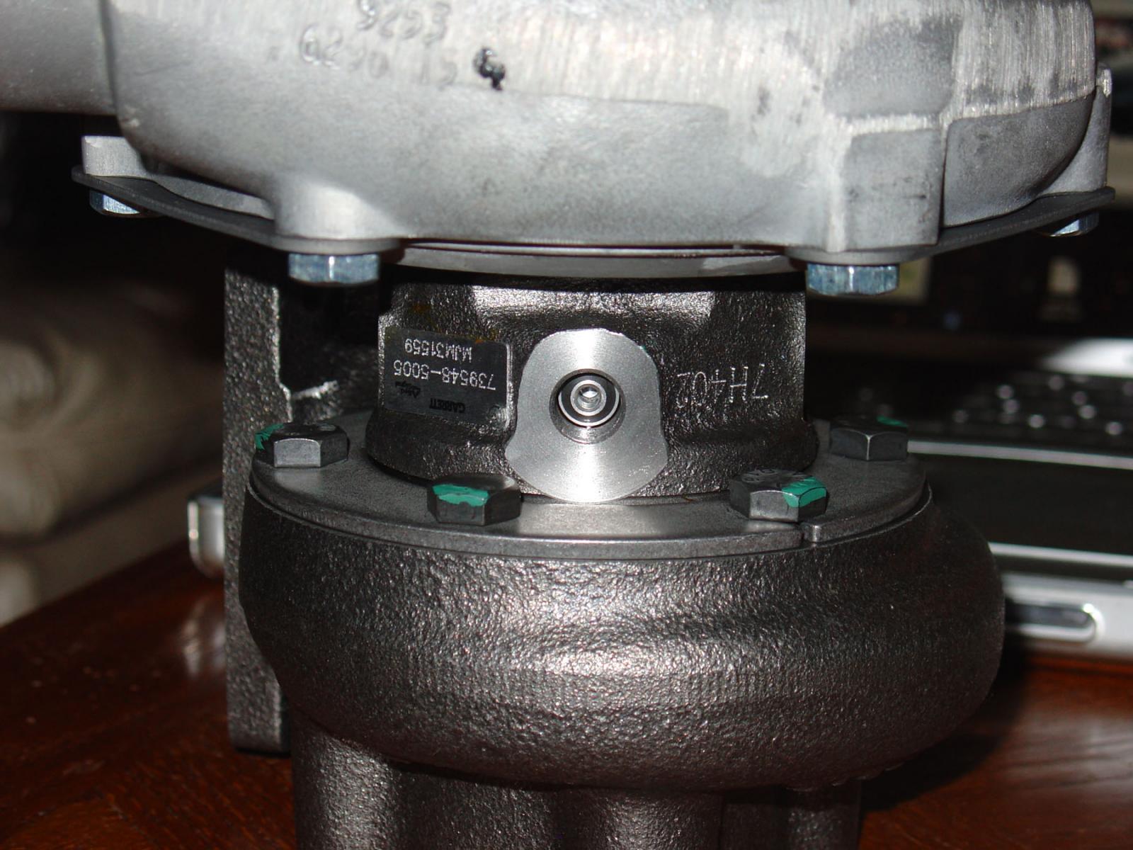

Penglii Posted July 29, 2010 Author Report Posted July 29, 2010 i am trying to imagine what you are describing as to having 6 bolts... i think i've only ever seen 4, like in that pic. Here is a pic... you can only see 4 of the 6 bolts, obviously the other 2 are on the other side. Quote
RobertISaar Posted July 29, 2010 Report Posted July 29, 2010 weird.... must be a newer GT thing... are they squared with just two extra bolts between, or are they all 60* apart? Quote
Penglii Posted July 29, 2010 Author Report Posted July 29, 2010 looks to be all 60* apart. The more I think about it, the more I doubt that the number of bolts in that housing will really matter... Quote
