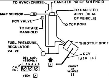

RobertISaar Posted August 6, 2010 Report Posted August 6, 2010 91. I thought the Map sensor was the blue and red plug with the larger vacuum line attached red and blue plug sounds like the purge solenoid for the carbon cannister. MAP sensor has 3 wires, purge solenoid has 2. the purge solenoid also has two lines attached to it, compared to the 1 the MAP sensor has. 40kpa abs is like 40% of atmospheric, which is like around 30" Hg. so a reading of 18" Hg (gage) should be the same. sounds about right. Quote

mra32 Posted August 7, 2010 Author Report Posted August 7, 2010 red and blue plug sounds like the purge solenoid for the carbon cannister. MAP sensor has 3 wires, purge solenoid has 2. the purge solenoid also has two lines attached to it, compared to the 1 the MAP sensor has. sounds about right. Robert, thanks for the diagram. I noticed it didnt have the attachment on the intake manifold for the brake booster. Thats a vacuum line, right? Should there be any more vacuum lines to worry about Quote
RobertISaar Posted August 7, 2010 Report Posted August 7, 2010 well, that was emissions lines, which should have covered most of them, and actually shows the HVAC line too.i can't think of any more that would be present, except maybe a vacuum resivoir. Quote
