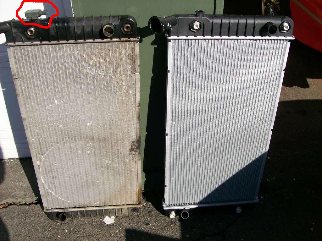

mediabandit Posted July 16, 2010 Report Posted July 16, 2010 This is for the LQ1. The low coolant light is a bad coolant level sensor which is found on the passenger side of the radiator about 6" down. One small metal wire clip holds it on, just pull it back, unclip connector, pull sensor out, replace with new one and slide the wire back on it, and then plug the connector back into it. It is the circled piece in the pic. Quote
jaustinbell Posted July 16, 2010 Author Report Posted July 16, 2010 ABS light: remove and clean off the ABS sensors. Pan drop actually drains ~8 quarts out of I believe 12 total. Do you have a transmission cooler? I wouldn't worry about the struts if everything is running perfectly. Low coolant light should be a sensor. I forgot which one or where it is. Alright, I will have the shop read the code for which wheel it is, then I will clean the ABS sensor. There is the usual transmission cooler in the radiator, I haven't added one or anything. OK. Alright then I'll grab one or two at the junkyard this weekend, thanks. Thanks for the info on finding and replacing the sensor. Quote

jaustinbell Posted July 24, 2010 Author Report Posted July 24, 2010 Put in the new (used) tensioner and that fixed the rattling. Put in the new (used) low coolant light sensor and while the car was cranked up in the driveway for a few minutes, the low coolant light stayed on--I can see that the coolant is at the top of the radiator filler neck, so who knows. The car was on for about 4 minutes idling in the driveway, and a couple times the idling got really rough--well, it wasn't really rough so much as the RPMs were swinging up and down wildly, from about 600 to 1300 back and forth quickly. It doesn't normally do that, and probably wouldn't have if the car was being driven. No check engine light. Quote

Crazy K Posted July 25, 2010 Report Posted July 25, 2010 I have tested a bunch of those low coolant sensors. there is about a 50% failure rate. you probably got a bad one. try again. Quote
GnatGoSplat Posted July 26, 2010 Report Posted July 26, 2010 I hate those stupid low coolant sensors. They go bad easily and often. Cleaning the prongs doesn't help either. Quote
