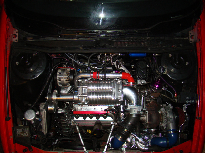

Miko K Posted July 15, 2010 Report Posted July 15, 2010 I did all kinds of searches here and everywhere, can't find out the truth about radiators. Advance auto offers a single row 1 3/8" thick: http://shop.advanceautoparts.com/webapp/wcs/stores/servlet/product_Radiator-Ready-Rad_19920448-P_31_R|GRPCOOLAMS_1443183692___ I found this one and a few more on ebay that is a 2 row 1" thick: http://cgi.ebay.com/ebaymotors/ws/eBayISAPI.dll?ViewItem&item=280500063895&ssPageName=STRK:MEWAX:IT What is your experience with radiators guys? I went to the local yard today and only saw single row big radiators on the 3800 and DOHC cars, I am going to get a brand new one just for a peace of mind but just trying to get the best one. Quote

Miko K Posted July 16, 2010 Author Report Posted July 16, 2010 (edited) mine is an 1 1/4" thick, stock gtp is 1" and 3xxx w-body's are 5/8" at least the ones i've seen. you have to specify that you want the oversized one or they will send a stock replacemnet. Can you actually measure the core size? I have not been able to find anything over 1.076" yet. My GTP had a 5/8" radiator The pic on the ZZP site is the same exact one as the ones that NAPA and Advance sell. It really confusing... As far as the clearance, I am going to use a set of 16" slim fans, I will move my liquid intercooler between the bumper and the radiator and will move the radiator aft about an inch and a half to get more airflow. I have the room with my homemade powerlog style headers. Right now the intercooler is blocking the airflow pretty bad and the pusher fan in front of the radiator isn't doing much. Thanks for all the replies guys! I hope that we can find out all the mysteries aroudn these radiators . Edited July 16, 2010 by Miko K typo Quote
