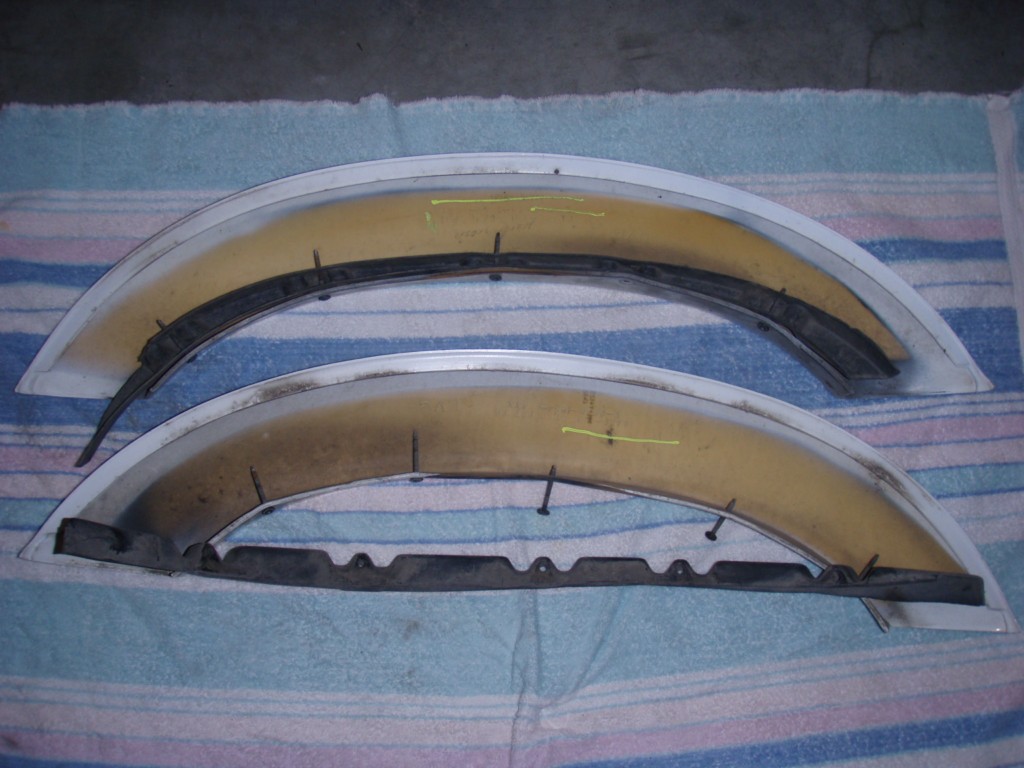

i started putting my tgp back together and i can't figure out for the life of me how the front fender flares go on. i can slide the flare on the fender clips and it will sit tight. but, when i look underneath to start bolting the fender to the flare, it looks like there is nothing for the flares to olt to.
it appears that there is a piece that goes between the flare and the fender. if so, mine are missing. i can't imagine where these parts would be excepct in the car, and they aren't there.
there is a gap between the flare and the fender big enough to put my hand in.
here are a couple pics:
yes sir you are missing the spacers. They are about a 2' long and have the holes spaced in for lining them up. I have a full spare set I could take pictures of for you.
I will be home from work trip tonight should be able to get something to you then.
Here is the picture of the inserts and the B4U flares you were looking for. The insert spacers are perfectly spaced for the flares. These are my backup pieces so I can't part with them. Hopefully you can find the originals under a pile of junk somewhere.
well, thanks a ton for the pics. i don't remember ever taking those off of the car, so i doubt i have them.
i'll see if i can order them from the stealership if i can't find them at the junk yard
again, thanks
