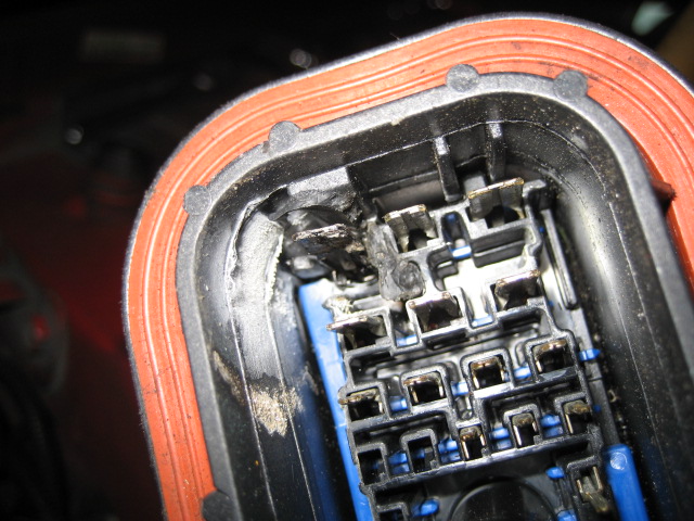

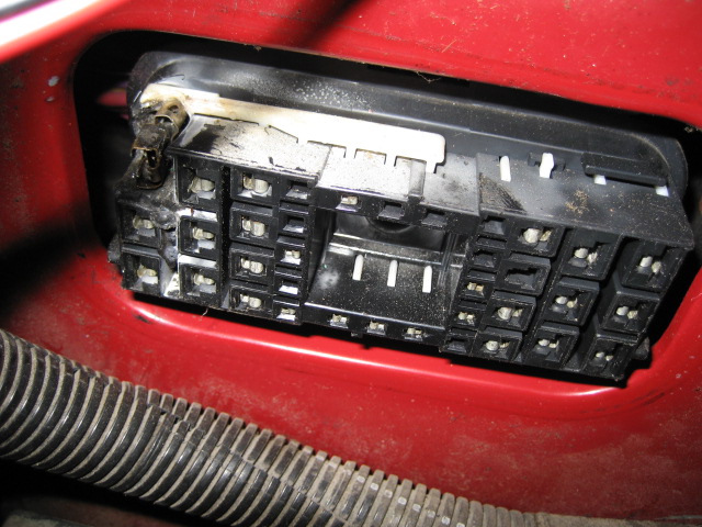

GnatGoSplat Posted July 10, 2010 Report Posted July 10, 2010 I dont understand how more light can be a bad thing? My low beams are indented, so when i turn my brights on and my foglights go out i lose quite a bit of light. I think it's mainly that high beams in fog is bad because it reflects off the fog and reduces visibility. I don't think there's anything wrong with fogs on all the time, but they're not supposed to be useful for anything but fog. Driving lights are designed with a beam pattern that can assist with high-beams, but these cars don't come with driving lights from the factory, just fog lights. There's also a concern that all 6 lights on at the same time could overload factory wiring. I can speak from experience on that one, in my high school days I had 100W H3 bulbs in my fogs and ran them with low beams all the time. That eventually melted my C100 connector. Quote

GnatGoSplat Posted July 11, 2010 Report Posted July 11, 2010 idk what factory is but im thinking if i use a 100w 9005 it should be bright enough. I would recommend trying HIR bulbs before going higher wattage, but if you must go higher wattage, I can't stress enough the importance of using an upgraded wiring/relay kit. I now use one anyway, just in case. Here's what happened to my C100 connector just using 100W fogs in place of the 55W. Quote
