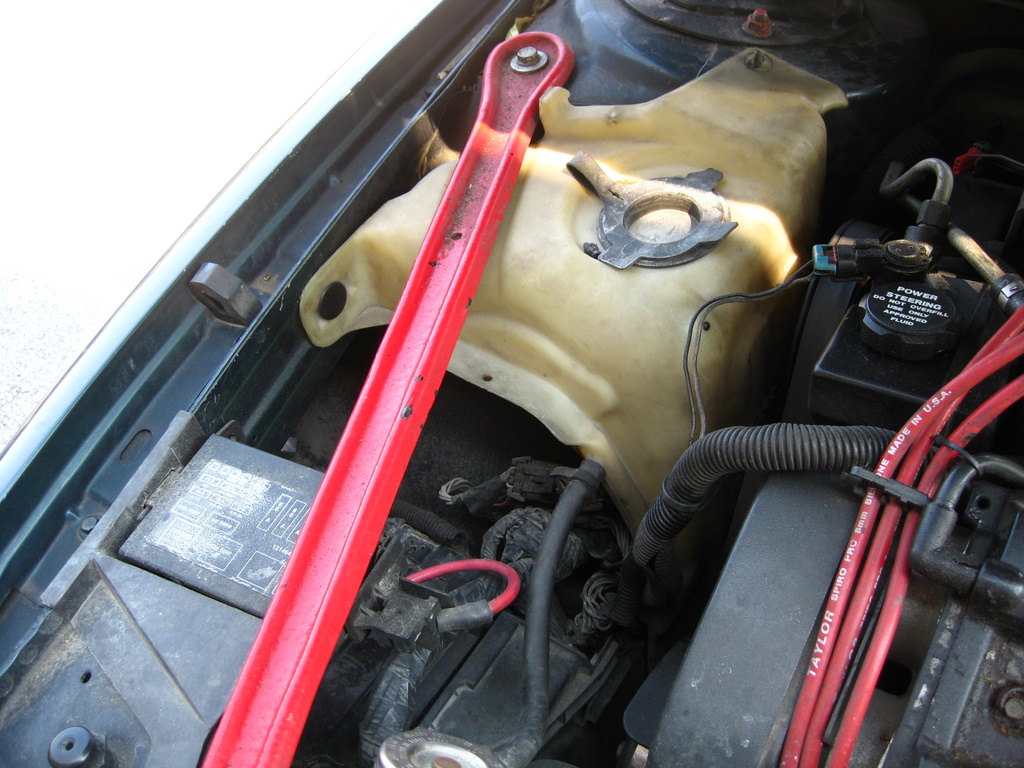

bronze93 Posted July 4, 2010 Report Posted July 4, 2010 I'm looking for some pics in the area of the coolant bottle by the PCM. The PO just didn't put stuff back the way it should be. I've got wires laying all over the place but the connectors have push plugs. So there has to be holes from them to mount to. Also, the coolant line that is over there, the one that runs toward the back of the engine, is rubbing against the pulleys so that would need a way to pull it towards the frame. Thanks in advance, Quote

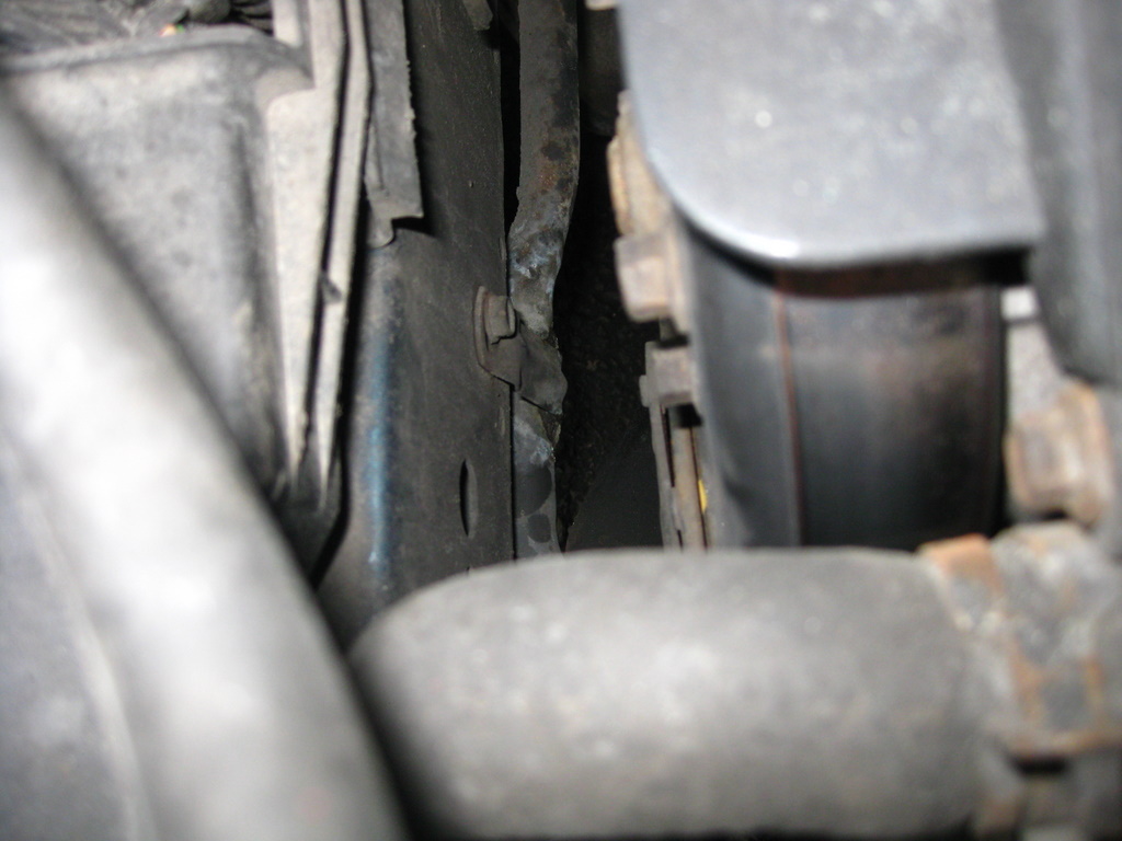

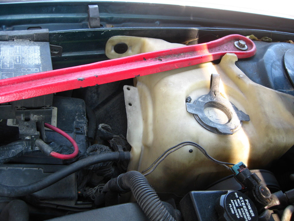

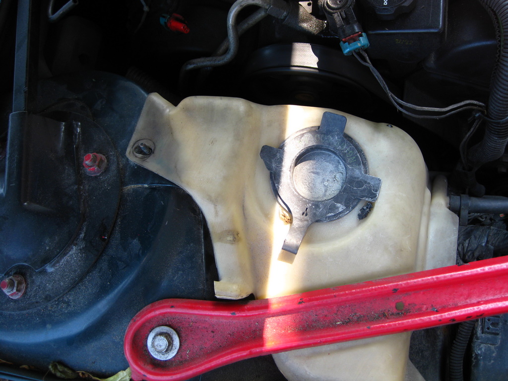

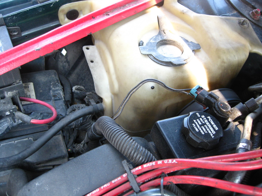

bronze93 Posted July 5, 2010 Author Report Posted July 5, 2010 Thanks for the Pics. I seem to be missing a cover for the pcm plugs (circled in green). Where do these connectors (Circled in Yellow) mount? This one is a little hard to see but it's the hose that comes from the water pump to the rear of the engine. Where does it mount so it doesn't rub against the AC compressor pulley? Quote

Crazy K Posted July 6, 2010 Report Posted July 6, 2010 the heater core return line is what you are looking at. You can see yours has been cut and patched before, thus the reason it is kicking out. ziptie time. Quote
Addicted to eaton Posted July 8, 2010 Report Posted July 8, 2010 ziptie it to where it was and forget about it! And all these dirty bays make me feel better about mine Quote
GTP091 Posted July 10, 2010 Report Posted July 10, 2010 Where do these connectors (Circled in Yellow) mount? [ATTACH=CONFIG]1311[/ATTACH] Those are the injector harnesses. Good for when removing the engine. It looks like your harness has been moved and bastardized. It should be loosely taped up and run around the back close to the firewall. I would strongly suggest taping it up and re-looming it so the flopping and bouncing it will be doing; doesn't cause a break. You'll find yourself back on here with no start or drivability issues if your injector harness gets damaged. It should have a loom clip attached to the strut tower, manufactures tie the wires down for a reason. you guys should also take a tooth brush and some armor all to your engine bays; do some before and after pics for us. Im afraid to look again but there was some leaves in those pictures. shameful... Quote

Crazy K Posted July 14, 2010 Report Posted July 14, 2010 the "injector harness" connectors right near the computer have those funny gray pins on one side, I can see at least one of them in the pics above. those go into the struts brace holes... which seem to be missing from your strut brace.... Quote
