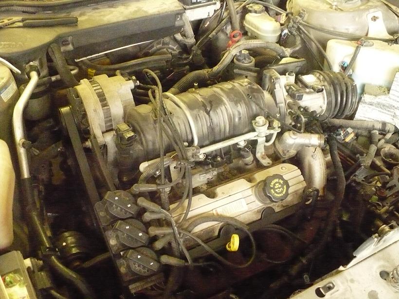

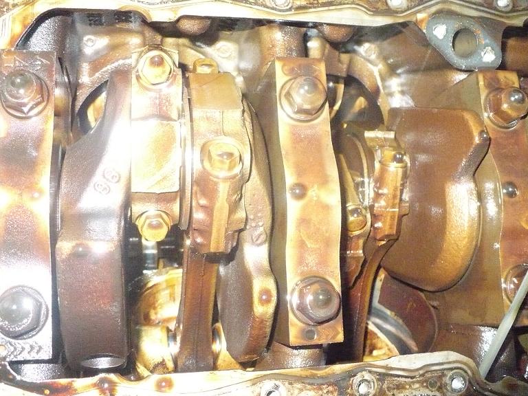

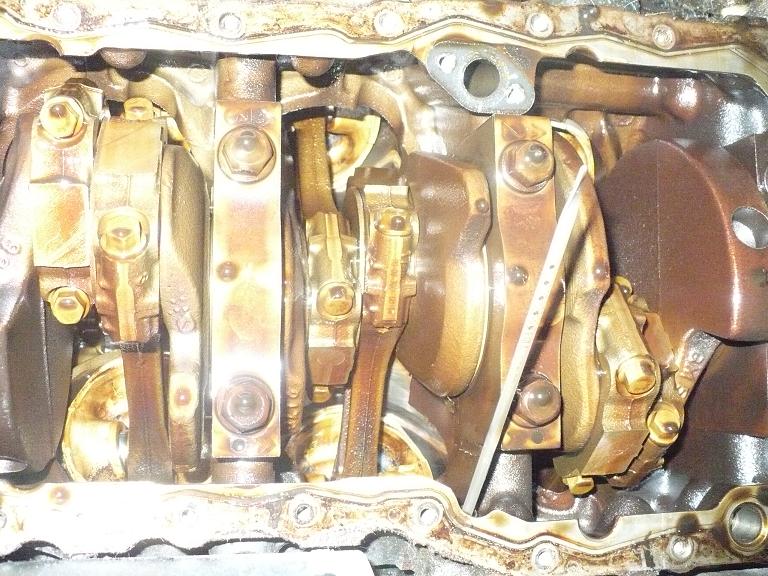

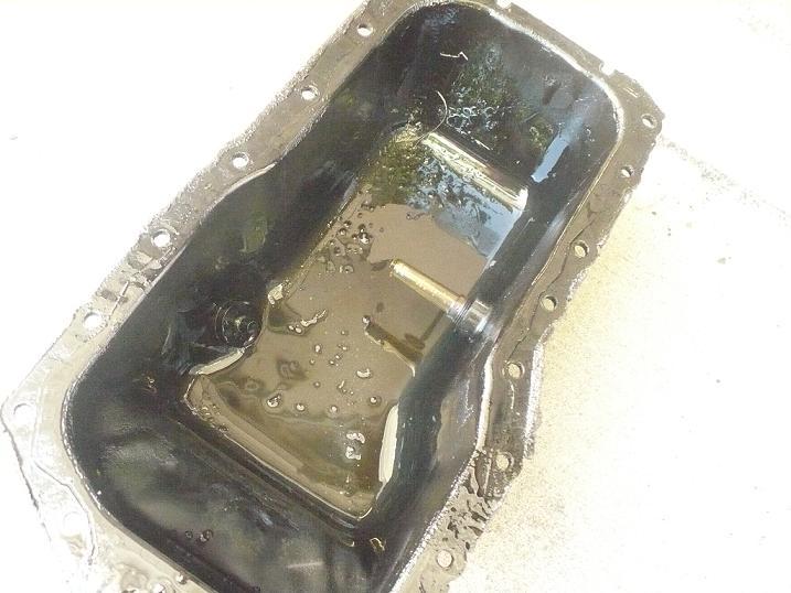

93cutty Posted June 27, 2010 Report Posted June 27, 2010 So I was driving through the country on a two lane yesterday when I came upon a slow moving tractor. I gently eased the gas down and moved into the opposite lane. I pull back into my lane and notice a KNOCK, KNOCK, KNOCK, What the freak. Thats right at 143k miles my heroic 3.8 known for its unbeatable reliability has developed a serious problem. I limp it back home and tear off the oil pan to find lots of metal. I swear the car gods are not happy with me. This is the fourth motor I have had to change this year. I'm thinking that the previous owner didn't change the oil that much since it was like tar when I got it. I'm going to pull the motor and do a basic overhaul on it changing the bearings, rings, timing chain, and I will probably have to have the crank turned. On a side note I found an interesting article on rebuilding the l67. http://www.thrashercharged.com/tech_htm/engine_tear.shtm Quote

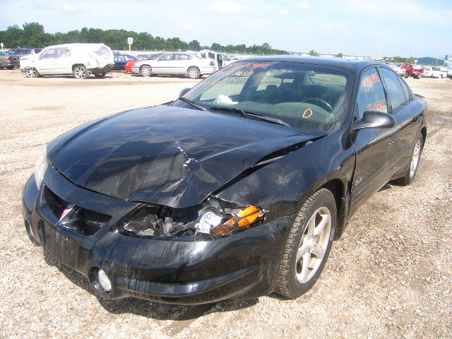

93cutty Posted June 30, 2010 Author Report Posted June 30, 2010 I like how you guys say these motors are cheap and plentiful. I want to shop where you do. Around here a low mileage 3.8 that is below 100k miles is 800 to 1000 dollars. 150k to 200k is around 500 to 600. That is why I wanted to rebuild. That would only run me around 300. Thank you cash for clunkers for making used car motors expensive. http://car-part.com/cgi-bin/search.cgi I'm hoping to pick this up for around 800 bucks, then I would have the wheels, motor, tranny, interior, and scrap the rest. Quote
