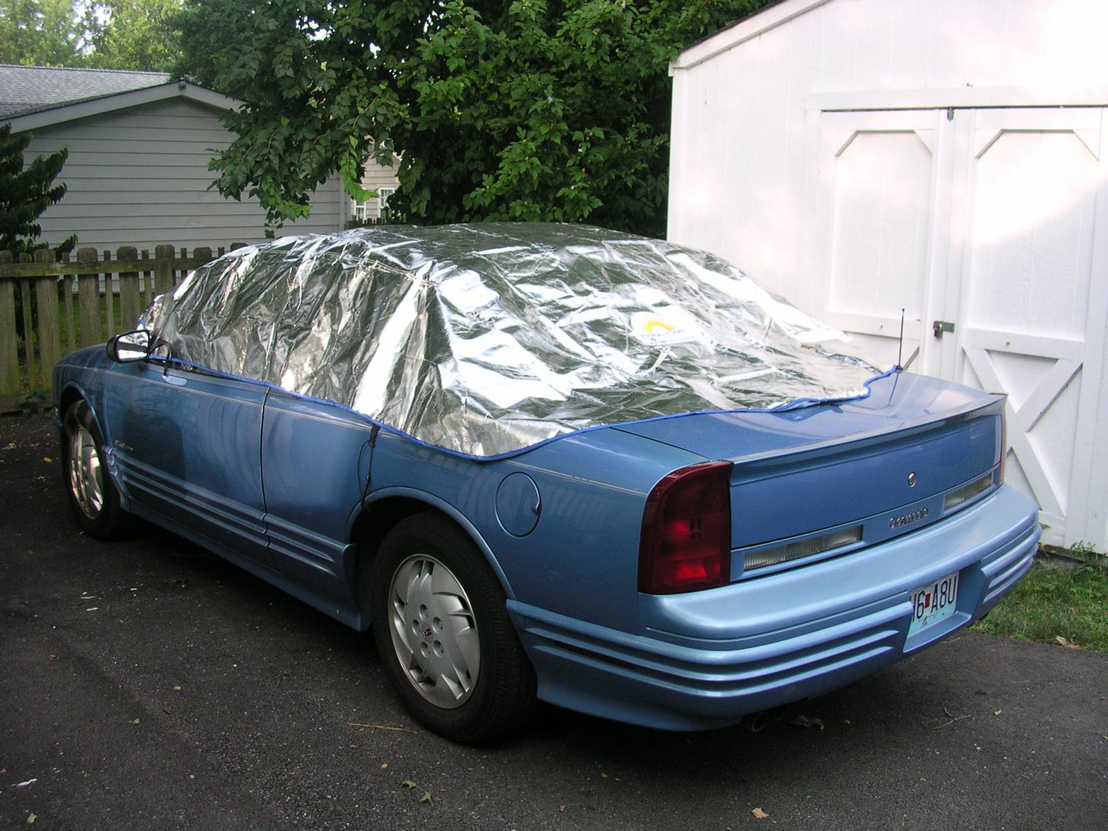

I would also like to see the pix. Our 1994 has the same problem and we bought a Cool Cap, which is a cover that reflects sunlight and heat away and is waterproof. It covers the top and windows only, but will shed rain water away from the interior. Your fix is more certain.

Here's a link to info. about the Cool Cap: http://itscoolinhere.com/store/store_standard.html However, I notice that the price is $20.00 higher than the $49.99 I paid about a week ago. I ordered my Cool Cap through CarParts.com and the $49.99 included free shipping. The standard size Cool Cap has two straps that are secured by velcro straps around the outside mirrors and "soft hooks" that can be attached to the rear of the cover and hooked into the rear wheel well. As you can see in the photo, the fit is not perfect: the cover is slightly narrower than it should be to cover from belt line to beltline on each side of our Cutty and is longer than is needed. It's fairly easy to put on and take off. We bought it to keep the water out of the convertible but in our recent 100 degree weather, the reflective cover also keeps the graphite leather from getting too hot. DISCLAIMER: I'm not affiliated with Cool Cap or CarParts.com, just a satisfied customer.
well... I have been wondering why such a thing doesn't exist... but apparently it does. this is a good idea in my book.... but I agree it is not quite wide enough....
