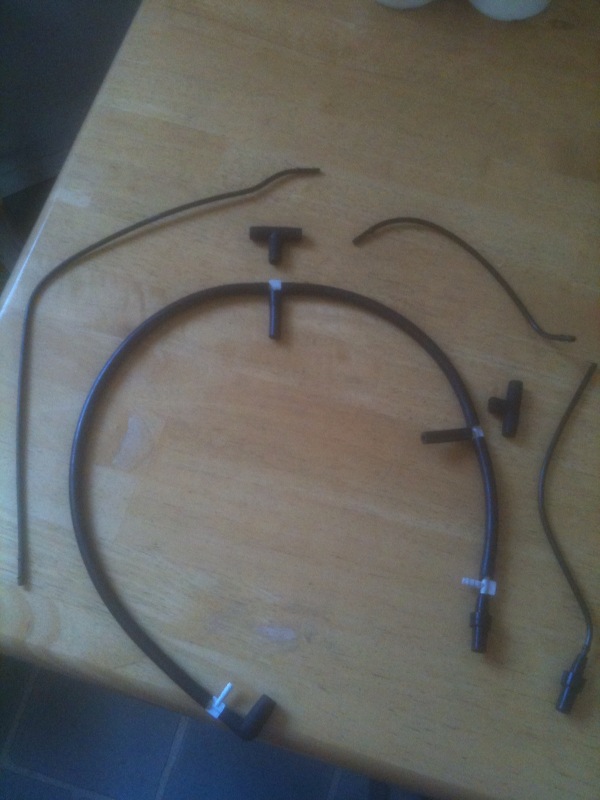

Mach Jace Posted June 14, 2010 Author Report Posted June 14, 2010 This is what I've got going on so far, I still need to go back and get some end plugs, another L joint (the one on there is apparently cracked as well, and 2 more 5/8 T's. Im using the 1/8's on there now for the extra 2, only two came with the package so Im just going to go back and get 2 more 5/8's before I install it. But it seems like it'll work. Quote
wickedbuick Posted June 14, 2010 Report Posted June 14, 2010 This is what I've got going on so far, I still need to go back and get some end plugs, another L joint (the one on there is apparently cracked as well, and 2 more 5/8 T's. Im using the 1/8's on there now for the extra 2, only two came with the package so Im just going to go back and get 2 more 5/8's before I install it. But it seems like it'll work.[ATTACH=CONFIG]1103[/ATTACH] Looks like you've got it! Let me know if that doesn't work for you. I don't think you'll have any problems though. Quote
Mach Jace Posted June 14, 2010 Author Report Posted June 14, 2010 (edited) This T is giving me a problem, the old T on the right got overstretched and broke off from them trying to put it on the nipple, and my little 5/32 tubing wont go over the nipple without damaging it. I'd get a larger tubing for that specific nipple but then it wont fit over the universal T Small piece of 5/32, some sort of adapter and some 1/4? Edited June 14, 2010 by Mach Jace Quote
Mach Jace Posted June 14, 2010 Author Report Posted June 14, 2010 Oh wow, nevermind, I've got an adapter in the kit I bought that'll fit just perfectly. Zing! Quote

xtremerevolution Posted June 15, 2010 Report Posted June 15, 2010 Oh wow, nevermind, I've got an adapter in the kit I bought that'll fit just perfectly. Zing! Looks like everything is coming together perfectly. Good job! Quote

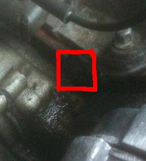

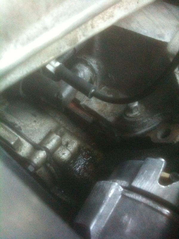

Mach Jace Posted June 15, 2010 Author Report Posted June 15, 2010 EPIC FIX! I legitimately scared the living shit out of myself when I accidentally floored the gas in park instead of the brake, I think I woke the whole neighborhood. The car freaking roars, and its nice to finally feel its full potential without that vacuum leak and the mis. Thanks for all the help guys. One more small thing, I'm "pretty" sure there's supposed to be a bolt here, judging from the oil that's dripping out of this hole... Either that, or its how the magical flux capacitor works in order to fuel that crank shifter sensor beam...laser...thing. Anyone know what size it is? Sorry if the picture is a bit dark. Quote
xtremerevolution Posted June 15, 2010 Report Posted June 15, 2010 Can you circle that in Ms paint? Sent from my T-Mobile myTouch 3G using Tapatalk Quote
Mach Jace Posted June 15, 2010 Author Report Posted June 15, 2010 Sorry Andrei, I can't circle it, best I can do is square it. Quote
xtremerevolution Posted June 15, 2010 Report Posted June 15, 2010 Does anyone here have an L67 that can look at that stupid bolt hole that's directly under the LIM to figure out what in the world is supposed to plug it up? Quote
Mach Jace Posted June 15, 2010 Author Report Posted June 15, 2010 Photo enhanced for your viewing pleasure: Quote

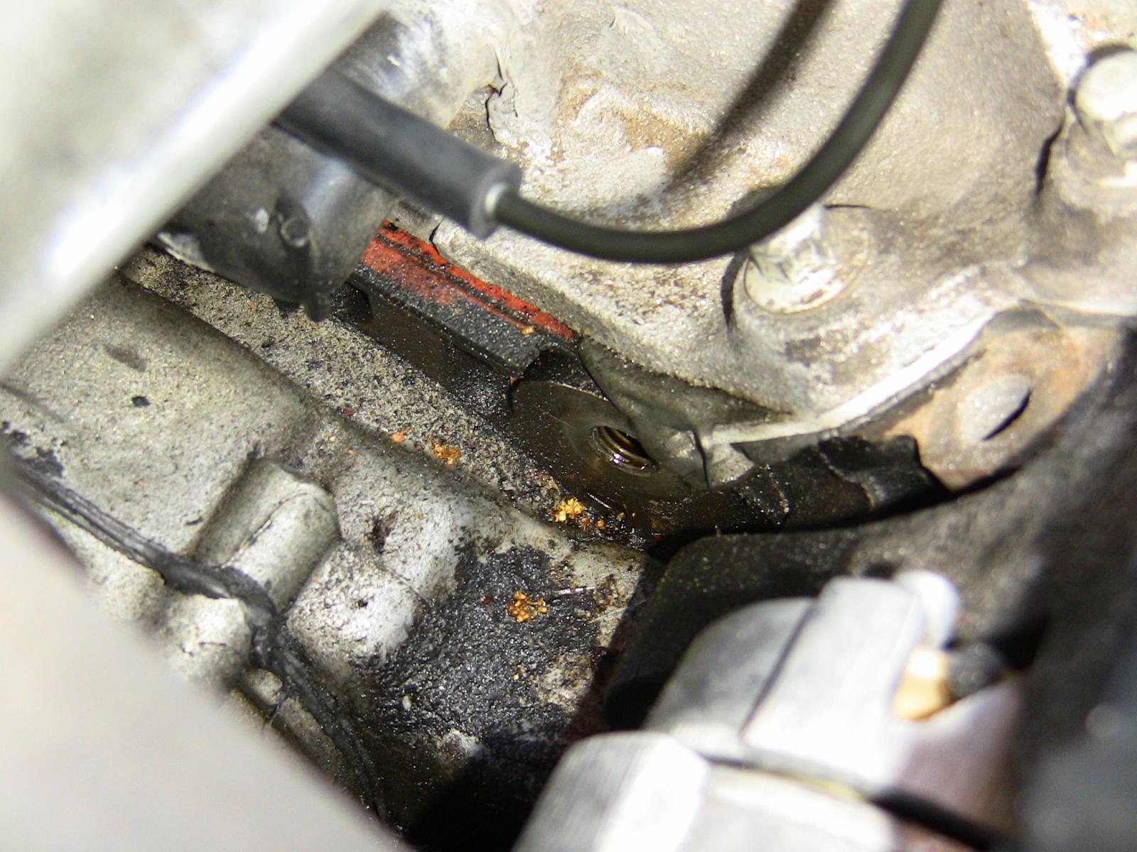

wickedbuick Posted June 16, 2010 Report Posted June 16, 2010 I took some pics last night but I forgot my damn memory card at home lol Yes there is a torx head bolt in that hole. I have not tore one of these engines down completely so I can't say what its for. I can't see it being a major issue if you've been driving like that and you still have 90% of your oil at all times. I didn't remove mine so I can't tell you the thread pitch, diameter, or length to get a replacement. It's cheap enough to buy a few diferent ones from lowes and just return the ones that don't fit though. I'll post the pics up tonight. Quote
Addicted to eaton Posted June 16, 2010 Report Posted June 16, 2010 LOL, ass beat me to it! there ya go, Not a major issue But it plugs up a hole going on to the lifter valley. Quote
xtremerevolution Posted June 16, 2010 Report Posted June 16, 2010 LOL, ass beat me to it! there ya go, Not a major issue But it plugs up a hole going on to the lifter valley. Any idea what purpose it serves? Quote
Addicted to eaton Posted June 16, 2010 Report Posted June 16, 2010 I pulles it out, its 3/4's and inch long, It keep stuff from getting in the oil of our cars. My guess, maybe the its a place for the coil bracket to bolt to on other 3800 powered cars (non w-body) Quote
wickedbuick Posted June 16, 2010 Report Posted June 16, 2010 (edited) Any idea what purpose it serves? Not sure exactly. I put my cam in and had the whole top end off and never paid attention to that bolt lol Maybe some secret port that dealers use for diagnostics lol Question should be is it on the L36 and if so maybe the hole is for brackets or something on an Fbody application....... EDIT: Duh it would be on the L36. lol I meant is it on all series 2 3800's or something in its place haha Edited June 16, 2010 by wickedbuick Quote
