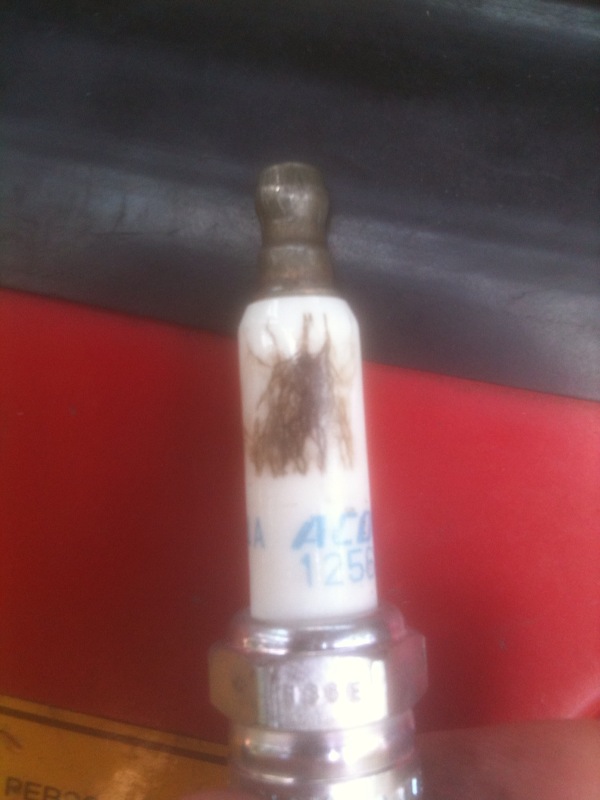

Mach Jace Posted June 12, 2010 Report Posted June 12, 2010 (edited) Problem solved! So a little rundown: Recently I went on a 2k mile roadtrip to Idaho:canada: When we got there, I had a cyl 3 misfire:damnit1: Replaced spark plug on cyl 3:f5: Ran good for a bit while we were there:buddy: Misfired again:damnit1: Diagnosed it, cyl 3 misfire went away and fuel injector error came up:damnit1: Replaced fuel injector 3, vowed to replace O rings once I got home:mmhmm: Good for 200 miles home, error came up again, started misfiring pretty bad:damnit1: Took it to get a scan, said it might be the wires or fuel filter:ohdear: Prayed to make it home:3: Made it home:saaaa: Ordered new wires, filter, and O rings:gr_grin: Havent driven it since:coal: Received new parts in mail yesterday:high5: Went to install parts, and found this on cyl 3 spark plug: Black/brownish burn veins all around the cyl 3 spark plug from where the wire covered it. Is this just because it was a bad wire? Or should I not bother putting the new wires on and a new spark plug in because its something entirely different that's wrong? I know its not the coil packs cause we tested those and the rest of the spark plugs are all good. Edited June 15, 2010 by Mach Jace Quote
RobertISaar Posted June 12, 2010 Report Posted June 12, 2010 looks like the insulator cracked there and then arced through/around the boot.... yeah, i'd say that's what was causing your issue! Quote

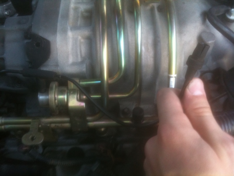

Mach Jace Posted June 14, 2010 Author Report Posted June 14, 2010 (edited) The fuel injector on 3 is fine, no corrosion or anything and its still having a mis. After swapping the old 3 to 1, I just replaced 1 with the new injector, and 3 is using the old 1 injector. Yet now its still misfiring on 3, so Im willing to bet its not the injector, turns out, its probably something a lot smaller-like so: You guys think getting a new fuel pressure regulator vacuum sce tube connector would fix it? Some idiot put electrical tape on another part of that tube. Anyone know what this part looks like? There's no picture -.- http://www.oehq.com/acdelco-parts_12570619_ACD_ACDelco%20Fuel%20Pressure%20Regulator%20Vacuum%20SCE%20Tube%20Connector~1999%20PONTIAC%20GR Edited June 14, 2010 by Mach Jace Quote
Mach Jace Posted June 14, 2010 Author Report Posted June 14, 2010 Apparently a little further on, the T connector that goes into the supercharger was completely wrapped up in melted electrical tape. Tape came off, and lo and behold, the connector was so brittle it fell apart into little tiny pieces. American parts ftw! But seriously, what kind of dumbass puts electrical tape over a fuel vacuum line that costs a measly 20 dollars to fix? Whoever said duct tape fixes engine misfires was sorely mistaken. Quote
Mach Jace Posted June 14, 2010 Author Report Posted June 14, 2010 Still have to order the hoses and T attachments, theoretically speaking that should do it. It's very likely that mis was caused by lack of pressure in the fuel lines because of the vacuum hoses, guess I'll just have to wait and see. Quote
xtremerevolution Posted June 14, 2010 Report Posted June 14, 2010 Still have to order the hoses and T attachments, theoretically speaking that should do it. It's very likely that mis was caused by lack of pressure in the fuel lines because of the vacuum hoses, guess I'll just have to wait and see. You don't order those. They have a spool of them at the auto store! It is very likely indeed. If you have no vacuum at your fuel pressure regulators, then your fuel pressure will be too low, and your car will run like ass. Quote

Mach Jace Posted June 14, 2010 Author Report Posted June 14, 2010 (edited) They're not normal vacuum tubes bro, they come in a package with the rubber connector that I showed you and notches in the tubes to keep the pressure from escaping through the T's, the T's have to be special ordered as well apparently. And its mostly the T that Im concerned about and that split end piece because that's whats actually broken, the tube itself is fine. And low or high pressure, it still runs like ass Edited June 14, 2010 by Mach Jace Quote
xtremerevolution Posted June 14, 2010 Report Posted June 14, 2010 They're not normal vacuum tubes bro, they come in a package with the rubber connector that I showed you and notches in the tubes to keep the pressure from escaping through the T's, the T's have to be special ordered as well apparently. And its mostly the T that Im concerned about and that split end piece because that's whats actually broken, the tube itself is fine. And low or high pressure, it still runs like ass Did you got to the store yet and look through what they have? Keep in mind a vacuum hose is a vacuum hose no matter how big or small, and you can easily find a retrofit for the parts you're looking for, even if you have to use some adapters. This isn't a Jaguar or a BMW, its a GM w-body. All you need is vacuum pressure to be sealed. It doesn't have to be a 100% exact OEM replacement part. Quote
wickedbuick Posted June 14, 2010 Report Posted June 14, 2010 Did you got to the store yet and look through what they have? Keep in mind a vacuum hose is a vacuum hose no matter how big or small, and you can easily find a retrofit for the parts you're looking for, even if you have to use some adapters. This isn't a Jaguar or a BMW, its a GM w-body. All you need is vacuum pressure to be sealed. It doesn't have to be a 100% exact OEM replacement part. True story. I got a box of various sizes of T fittings and some vacuum line from autozone and was running again with no issues. The fittings are barbed so it seals nicely too. Quote
xtremerevolution Posted June 14, 2010 Report Posted June 14, 2010 True story. I got a box of various sizes of T fittings and some vacuum line from autozone and was running again with no issues. The fittings are barbed so it seals nicely too. This coming from another L67 owner. Jason, just make another trip to autozone. Quote
Mach Jace Posted June 14, 2010 Author Report Posted June 14, 2010 True story. I got a box of various sizes of T fittings and some vacuum line from autozone and was running again with no issues. The fittings are barbed so it seals nicely too. How much did the box of fittings cost you? And were you able to fit the T's over the pressure regulator and the supercharger attachment as well? Quote
