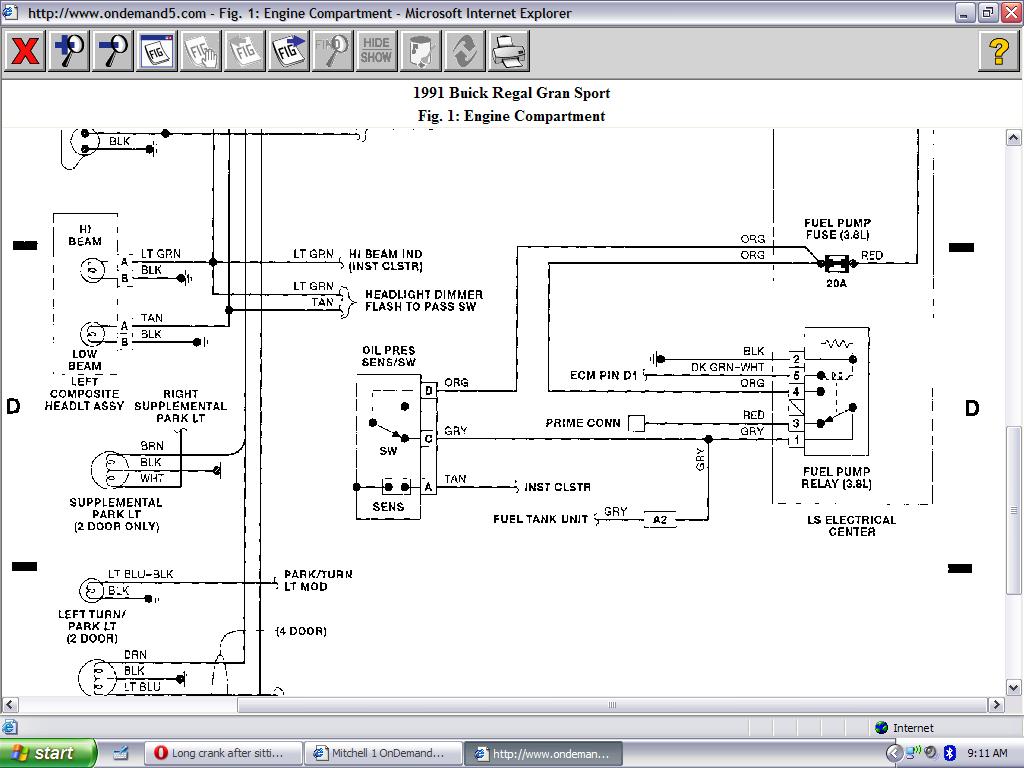

BXX Posted June 7, 2010 Report Posted June 7, 2010 Sounds like the fuel pump relay died or there is a wiring issue from the PCM to the fuel pump.. Causing you to have to crank until you build up enough oil pressure and then the oil pressure sensor/switch will trigger the fuel pump. So you need to verify you are getting the 12v on signal from the PCM (Pin D1) to the fuel pump relay (Pin 5, Dk Grn/Wht wire). Also verify ground of the relay (Pin 2, Blk wire). Start with that. Try swapping relays is the easiest. Note, use a multimeter!! not a test light. You need to make sure your getting a solid 12V from the PCM to the relay. Ive seen them only send out around 5-9V due to PCM/wiring issues which will not trigger the relay. Quote
alec_b Posted June 8, 2010 Author Report Posted June 8, 2010 Very good info! I'll definitely check into that as soon as I get some free time. Quote
