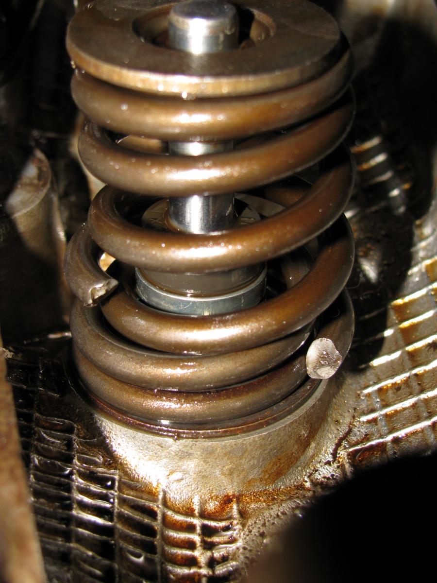

Toxie Posted October 24, 2010 Author Report Posted October 24, 2010 Well guys... I finally found time to tear it down this weekend...this is what I found. I'm going to have the valves seated and get all new springs and valve seals too. Anything else I should have done to the heads? Quote
tornado_735 Posted October 24, 2010 Report Posted October 24, 2010 Sweet Jesus! How in the shit did that happen? As for the heads, I think you're doing everything I would. You could top swap it since you're going to have the heads off, but that's up to you. Quote
