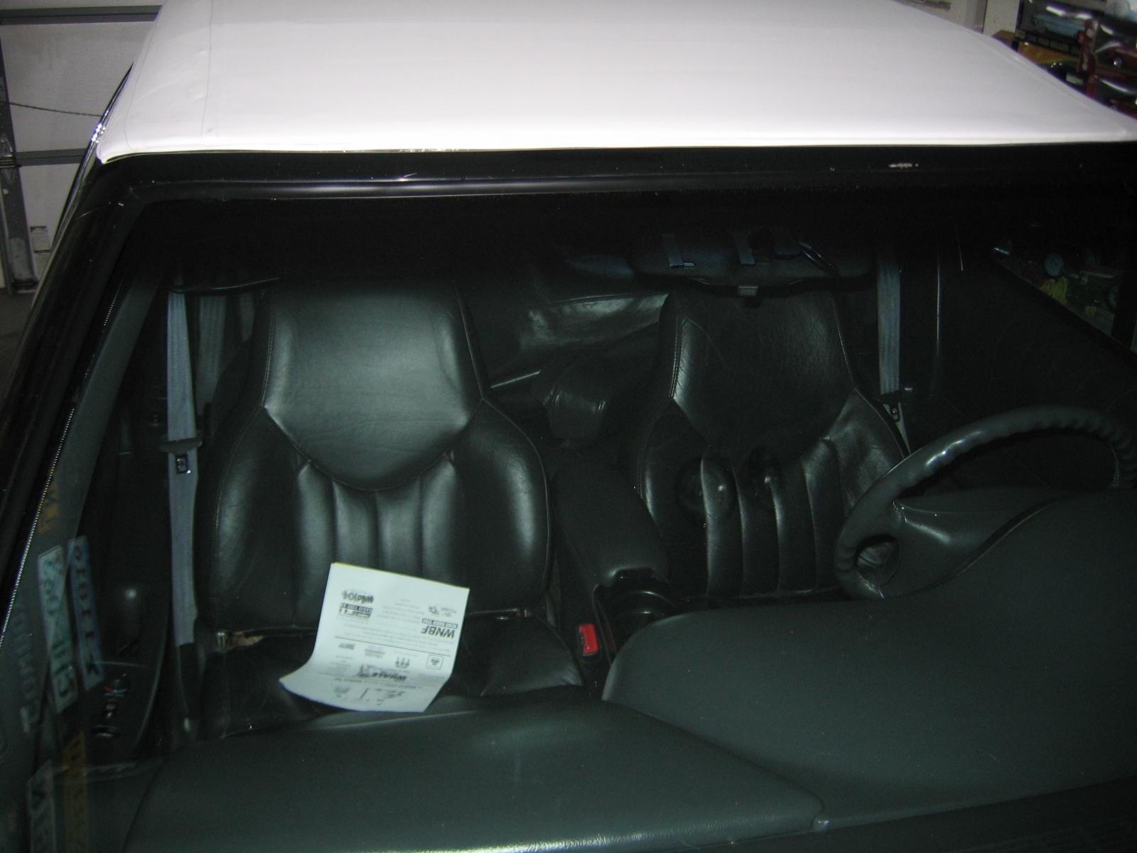

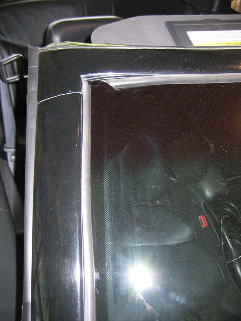

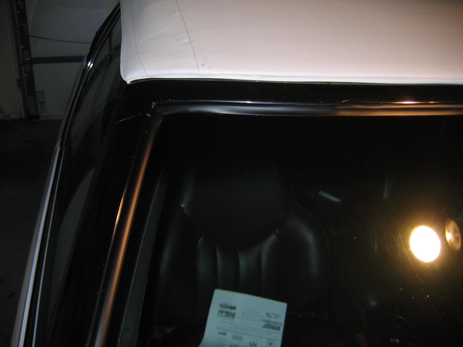

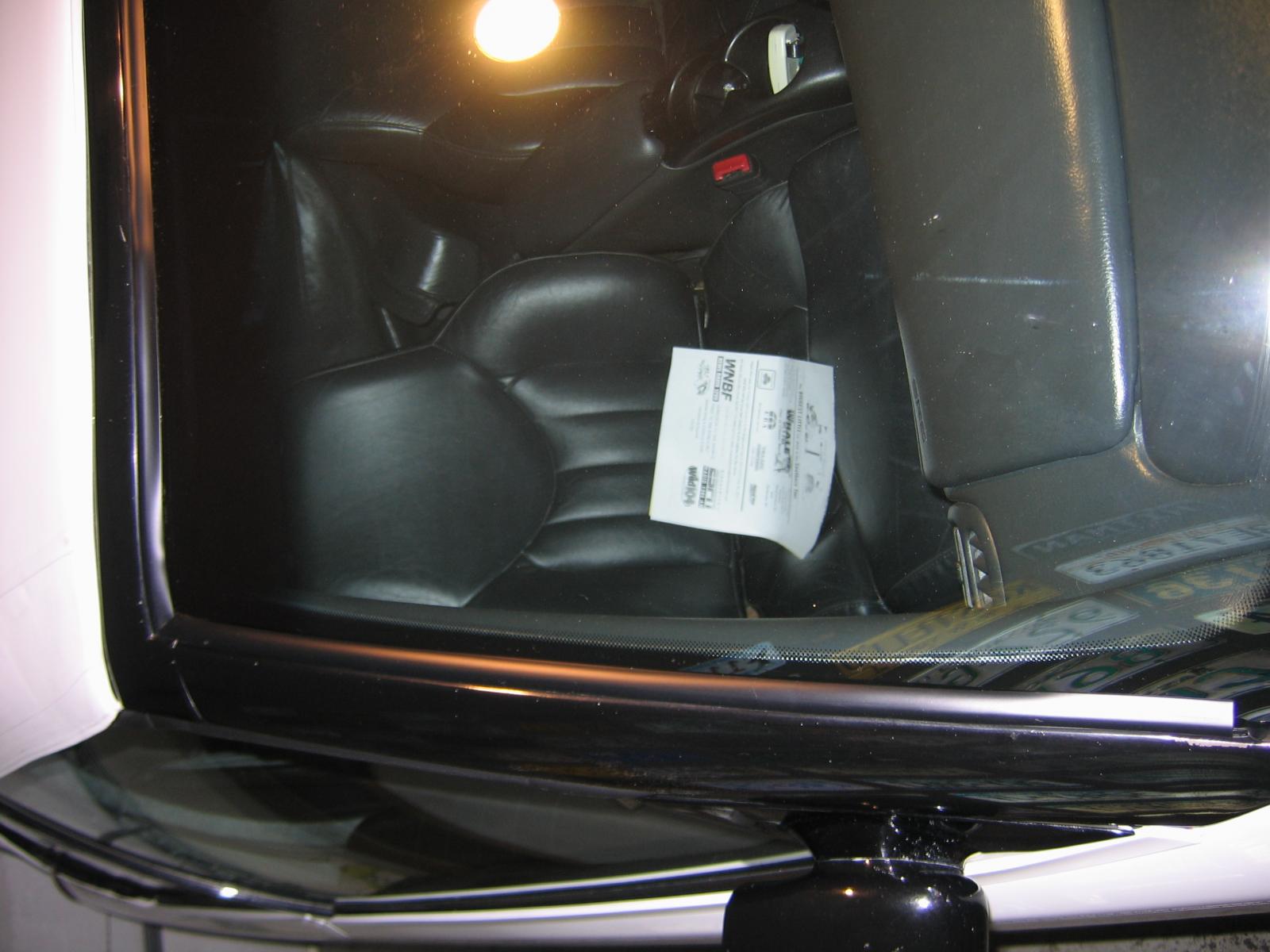

cliffcostello Posted June 7, 2010 Author Report Posted June 7, 2010 3]Could you post a pic of your windshield with the new weatherstripping? Here are a couple of pics of old molding and new molding. I wasn't the best at cutting the 45 degree angle on the corner ... may reorder and redo. Quote

94 olds vert Posted June 7, 2010 Report Posted June 7, 2010 (edited) Looks good to me. I am going to order up a set or two. Edited June 7, 2010 by 94 olds vert Quote

cliffcostello Posted June 9, 2010 Author Report Posted June 9, 2010 My experiences from getting them from junkyards is that they still separate in the corners. I've found a decent one before and when I tried to put it back on it was rather difficult. I am not going to mess around with 15 year old parts. If I can get something new it should last another 15 years. I agree ... the older rubber seals have dried out and hardened and shrunk. I didn't think $32 (included shipping) was a bad price, to get this seal all new and fresh looking. Its soft and pliable. Only thing you have to do is to cut the 45 degree corners ... and I personally didn't do as good a job as I should have .. may redo mine again. But in the end ... this looks 100 X better than the original .. which was pretty shabby looking. Took me about 30 min to take old off, clean windshield, and then put new seal in place. Takes some work to push it into place ... I've got to fix a few areas that I didn't get as tight as I wanted. But it does look much better!! Quote

cliffcostello Posted June 14, 2010 Author Report Posted June 14, 2010 Galaxie500XL: Yes, the new one I got was slightly wider than the factory ... but since I haven't found anything close to-date, this new one looks great ... certainly better than the faded, dried, and shrunk one that was there. The new one was very pliable, had a glue coating, and pressed into the windshield frame nicely. There were a few spots I had to work a little. Hopefully your Buick Century one works too. Quote
cliffcostello Posted June 14, 2010 Author Report Posted June 14, 2010 hello i order it and received how do i get the roundness ? does it have to be trimmed ? Not sure what you mean about "roundness? If you're talking about the corners of the windshield, you will have to cut the molding (45 degrees) with an exacto knife or a any sharp knife, or scissors. Knife works the best. If you're referring to the "roundness" of the molding from a cross section perspective, I found that I had to work the molding into place, after cleaning out the old trim and glue left behind. I used a razor to scrape the glass clean. Then I had to work the molding lip over the windshield frame ... and press it down and in. Ultimately, it pressed into place. I had a few areas which didn't go into place very easily ... and had to work it harder ... after letting it sit in sunlight, to soften the rubber up more. I hope this helps. Quote
cliffcostello Posted June 16, 2010 Author Report Posted June 16, 2010 do u have pics of y'all installs The only pics I have are the ones I posted in the thread .. 1st 3 pics are of the new molding, 4th pic is of the original. Quote
