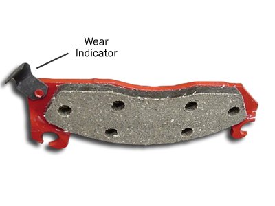

dodgethis Posted June 4, 2010 Report Posted June 4, 2010 I had swapped out my pads and rotors a while back and everything went well. What i noticed was a rattling noise coming from the passenger side after i had replaced everything (brake wise). What I found out is the two legs that extend from the back of the brake pad some how either bent or broke off and caused the pad to rattle inside the caliper. I wanted to ask you all how or what caused this, and what could I do next time to keep that from happening next time. I had used a large C clamp to push the piston back into the caliper slowly so to put the new pad in, just like the driver side, but some how it happend on the passenger side. Any thoughts? Quote
mra32 Posted June 4, 2010 Report Posted June 4, 2010 are you talking about the wear indicator? Its been a while...i cant visualize what you are talking about Quote
dodgethis Posted June 4, 2010 Author Report Posted June 4, 2010 Thanks for the reply mra32, its actually the pins (two legs) on the back of the pad that actually go into the piston of the caliper. Its how it is held into place when you push on the brakes and the piston kinda swallows the pins and thereby presses on the pad to the rotor. Quote
dodgethis Posted June 4, 2010 Author Report Posted June 4, 2010 See on the pad on the right, the legs that stick out like tweezers. This is what im talking about. Quote
mra32 Posted June 4, 2010 Report Posted June 4, 2010 hmm i probably had that on mine, but i dont remember seeing it. I think i remember the one on the left sliding onto the carrier or caliper. I think I have a full set of raybestos pads (front and rear, if you got the calipers) i'd let go cheap if youre interested. Brakes are subjected to a whole slew of crap...more than alot of people realize. I would think you just got a crappy pad. Sorry I couldnt help more Quote
