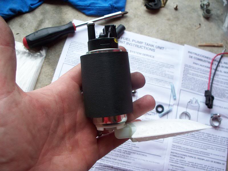

GnatGoSplat Posted May 27, 2010 Author Report Posted May 27, 2010 Nah, they look like this on the pump: I think the AC Delco and many aftermarket installation kits come with them, and the original pump has it too. It's for reducing noise and vibration (like the pulsator), but I don't know if it only makes a little difference or a lot. I can't imagine it making a lot of difference seeing as it's just foam, but I've been wrong before. Quote
RobertISaar Posted May 27, 2010 Report Posted May 27, 2010 i see... the little bag looking thing IS the prefilter, but not the poart you're missing... i really don't see that being very effective at all actually... might take away some pump whine, but i don't see it doing more than that. Quote
GnatGoSplat Posted May 27, 2010 Author Report Posted May 27, 2010 Yeah, I'm strongly leaning towards not worrying about it. I guess if it's noisy... well, that's what the volume knob on the radio is for! Quote

jtwmechanic Posted May 28, 2010 Report Posted May 28, 2010 just a simple noise/vibration damper, your choice with or without really doesn,t matter much. although if the pump is out and the sleeve is there then its always best to reassemble as factory. Quote

Crazy K Posted May 30, 2010 Report Posted May 30, 2010 I'm pondering a second use: COOLING. that thing soaks fuel in it and could help keep the pump cooler. I would reuse the old one it it has not stretched out. Quote
GnatGoSplat Posted May 30, 2010 Author Report Posted May 30, 2010 I couldn't use the original one from the TGP pump as it had deteriorated into a tar-like substance. However, I've changed fuel pumps in every W-body I own, so I took Ken's advice and reused an old one off a pump I pulled years ago (I save weak/intermittent ones, they make good all-purpose fluid extraction pumps). I've reassembled the TGP and after 5+ years, it's alive! Getting everything back together took about an hour, but that sure felt like the longest hour of my life. Felt like 6 hours. I'll be sore tomorrow from all that wriggling in and out from under the car. If I never do another W-body fuel pump, it'll be too soon. Quote
