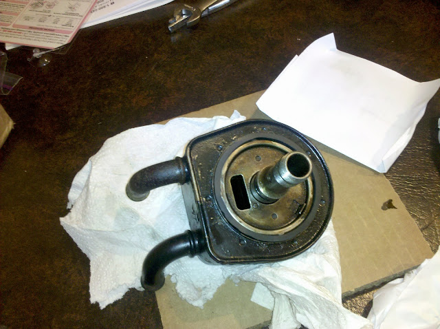

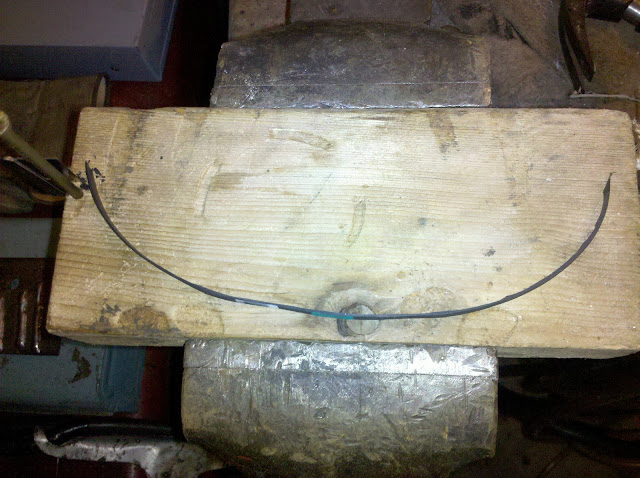

GhrarhG Posted May 22, 2010 Author Report Posted May 22, 2010 (edited) Ok, no luck on the GM part number. Went to advance and found the closest filter gasket possible: Then I had to trim the OD to fit the oil cooler using my high tech trimming device...A nail, 2x4, and a razor blade. It would have been better to trim the ID, but it fit no problem. Leaving this: and this: I called the dealer this morning, and they informed me that the gasket was discontinued with the P/N I listed above. They said that there was a possibility of getting one from some antique parts something or other for $35. This cost about $5, and took less than 10 minutes to do. Figured I'd post a solution if anyone else runs into this. Good Luck, Jon Edited May 22, 2010 by GhrarhG Quote
