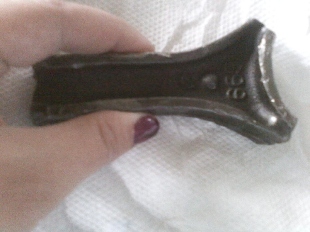

Z34guy Posted May 16, 2010 Report Posted May 16, 2010 Ari's Olds Intrigue is possibly dead. She had the Intrigue looked over by a mechanic, who gave it the ok. She had one of those random part failures no one can predict. We were driving down the road (I was driving. thank god or she'd have panicked and crashed), the engine was sounding increasingly sick so we were headed back to my Aunt's house to pick up my Monte Carlo. about 4 m,iles from my aunt's house, we heard a loud KER-CLUNK, followed by the oil light coming on, a metallic sound that went from the engine under the car, smoke started coming through the hood, and a loss of power steering. I pulled off to the side of the road calmly, put the hazards on and called my family for help, while Ari called her mom and then triple A. We then got out to inspect the damage. I saw a trail of oil behind the Olds and followed it to find out what happened. after about 30 feet, I found the problem. Connecting rod snapped and shot through the oil pan. Quote

Z34guy Posted May 18, 2010 Author Report Posted May 18, 2010 I'll post the picture of the connecting rod when I get a chance. Ari's leaning towards keeping it and having the bottom of the engine rebuilt (My sister won't relinquish her L67. fucking bitch... It's not like we're gonna save the car or that it's been on the road in the past year and a half.). She's hoping it won't cost more than $1000 to fix, but I think the cheapest it'll be to fix is $1200. Which is sad because she just spent $1200 on it to get the brake lines and fuel lines replaced. Her mechanic was BAFFLED as to how that happened. He said a few days before, it was running fine, and now it looks like she took it to a drag strip and raced it at 144 MPH then blew the motor. He's also baffled because Intrigues are some of the most reliable cars he's ever seen. He said he goes to junkuards frequently and most often when he sees an Intrigue, the body'll be rotting away and the engine'll be in perfect shape. Ari's car is the exact opposite. Quote
White93z34 Posted May 18, 2010 Report Posted May 18, 2010 shit happens. lord knows the life the car lived prior to this. it may have been driven on a bad intake seal with coolant in the crank case for lord knows how long, thats a quick way to wipe out a bottom end. I would not even mess with rebuilding a SII 3800. low mile examples are available for less then the cost of machining the block. Quote

Z34guy Posted May 18, 2010 Author Report Posted May 18, 2010 yea, Mass is near us. it's about a 2 1/2 hour drive but I also have family up there. And as I promised, the pic. Quote
tornado_735 Posted May 18, 2010 Report Posted May 18, 2010 Jesus fuck, you weren't exaggerating. Quote
White93z34 Posted May 18, 2010 Report Posted May 18, 2010 That could make a pretty sweet keyring. Quote
tornado_735 Posted May 18, 2010 Report Posted May 18, 2010 That could make a pretty sweet keyring. I approve of this idea Quote
Z34guy Posted May 18, 2010 Author Report Posted May 18, 2010 That could make a pretty sweet keyring. LMAO! you're the third person to say that. It's in my plans. Quote
