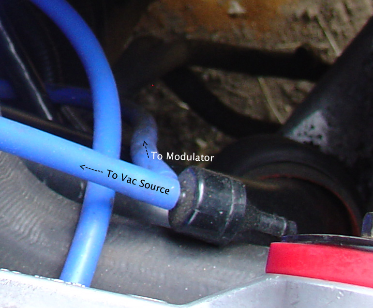

Penglii Posted July 21, 2012 Author Report Posted July 21, 2012 Got the trans mount changed out, wow it was easy to do. Still a jarringly firm shift into reverse, but it's tolerable now... I suppose I'll need to to the motor mount too soon. It no longer feels like it's just going to completely self destruct when going into reverse though, so that's good enough for right now. I'll do the motor mount in a couple of weeks I think. Quote
Garrett Powered Posted July 21, 2012 Report Posted July 21, 2012 your bleeder valve is on backwards then Quote
Penglii Posted July 21, 2012 Author Report Posted July 21, 2012 your bleeder valve is on backwards then Which bleeder valve? Please explain... Quote
Garrett Powered Posted July 21, 2012 Report Posted July 21, 2012 on the trans. just flip it and blow through it and all that make sure its going the right direction. had mine backwards by accident and that's exactly what it does. Quote
Penglii Posted July 21, 2012 Author Report Posted July 21, 2012 Gotcha. I replaced that valve once... at the same time as I replaced the trans modulator... I thought I had it on the right way, but it's posible it's on backwards. Here is a picture where you can sort of see it, I labeled the way I have the lines hooked up. Quote
Garrett Powered Posted July 21, 2012 Report Posted July 21, 2012 not sure which way either right now but try it? Quote
Penglii Posted July 21, 2012 Author Report Posted July 21, 2012 According to this picture mine is on correctly. I'm pretty sure the engine mount is blown and is causing the remaining jolt going into reverse... Quote

Garrett Powered Posted July 21, 2012 Report Posted July 21, 2012 blow and suck through it? adjustable modulator maybe? Quote
Penglii Posted July 21, 2012 Author Report Posted July 21, 2012 god I wish I had your problem sometimes. I can't not drive mine even with the busted x-over running pig rich... LOL I drove mine for a while with a busted x-over... but probably only for a month or so right after I got it. blow and suck through it? adjustable modulator maybe? Maybe... I'll check the valve and see if it's defective or something. I do have an adjustable modulator. All the forward gear shifts are great, it's just going into reverse that does it... I'd think that rules out the modulator. If I'm able to aquire a solid motor mount in time, I'll change it out this upcoming week... since I'm quite sure I need to do it anyway. Quote
Penglii Posted July 21, 2012 Author Report Posted July 21, 2012 D'oh! Just checked the check valve... one of the nipples broke off when I pulled the vac lines off it. So it's no longer important how well the old one worked... I gotta pick up a new one anyway. Good thing they are readily available at every parts store. Quote
