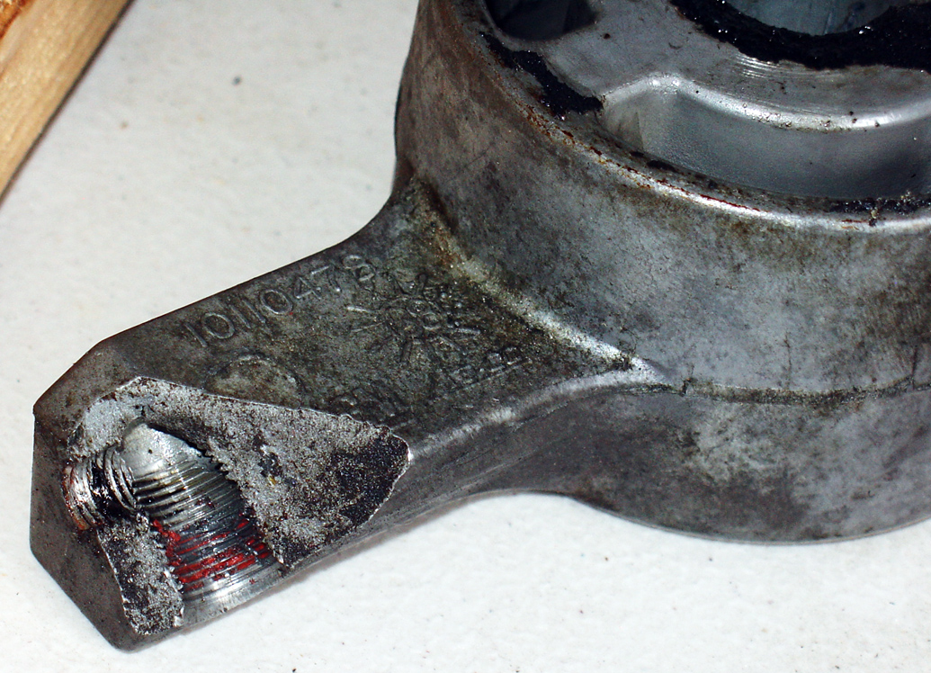

Penglii Posted June 24, 2012 Author Report Posted June 24, 2012 (edited) Holy balls... the paper gasket that goes between the OFA and the block just will not break loose! Gah!!! I just sprayed the crap out of it with PB Blaster... hopefully some of that seeps in there and breaks the bond. Update: Just got the broken OFA off.. had to resort to using a small prybar on the arm the pressure sender goes into. Sprayed a bunch more PB blaster on the gasket chunks that are still stuck to the block, gonna let it sit for an hour and try to scrape the old gasket off. OMG it is hot outside. Edited June 24, 2012 by Penglii Update Quote
Penglii Posted June 24, 2012 Author Report Posted June 24, 2012 Time for a fun game of "well there's your problem..." Here's a pic of my broken OFA, now that it's off the car. Quote
Penglii Posted June 25, 2012 Author Report Posted June 25, 2012 Well... got the car all buttoned back up. Took 7 tries and 2 paper OFA gakets before I got the oil filter stack to stay put. It's too dark outside to start the car and check for leaks, so I'll be doing that after work tomorrow. I really hope the oil filter stack is leak-free. The only gasket I was able replace outright was the paper OFA gasket. I ordered what was alledgedly a replacement o-ring for the filter stack bolt.... but it turned out to be a set of 2 shitty thin black o-rings. The diameter of the rings was fine, but they were way too thin, even 2 of them did not provide any resistance at all when inserting into the stack. Plus one of them incurred a gouge during the install. I did everything I could to clean up and rejuvinate the original o-ring, so hopefully that's OK, the OEM o-ring looks pretty resilient. I tried to cut a new oil cooler o-ring out of a Motorcraft FL-1A, but it turns out I really really suck at that... so I yet again did what I could to rejuvenate the original o-ring. I'll find out tomorrow how well I did. If that goes well I can bleed the brakes and start driving the car again. Quote

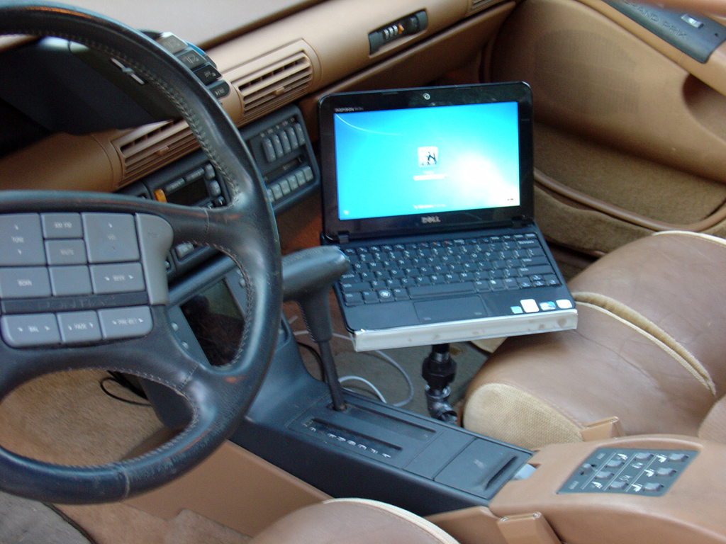

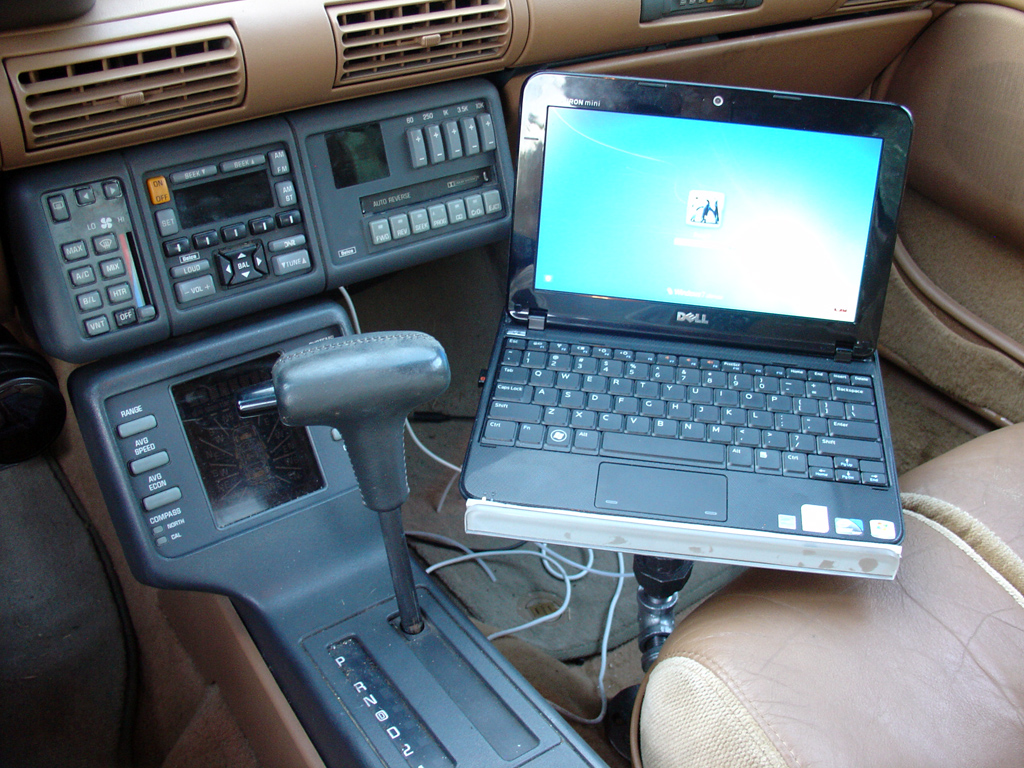

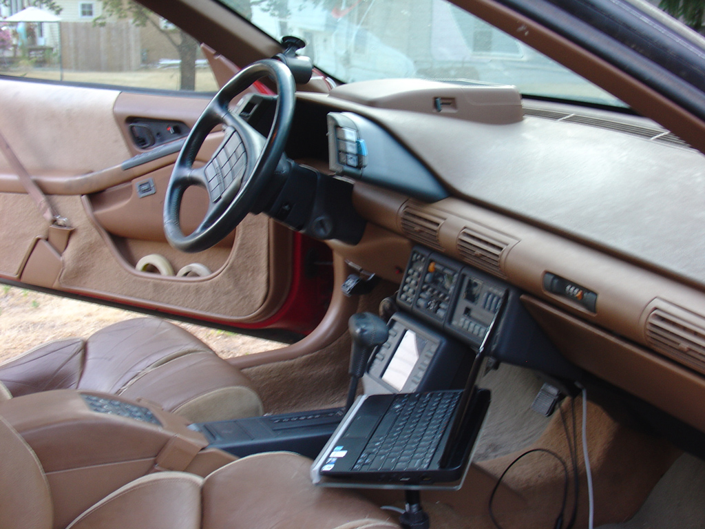

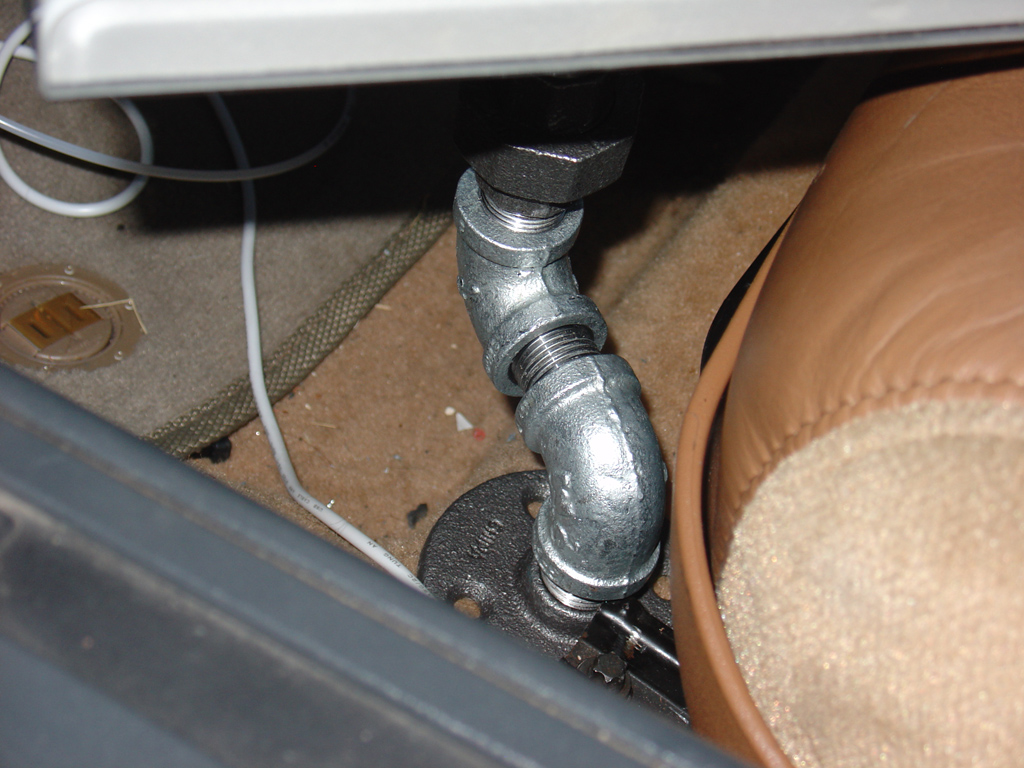

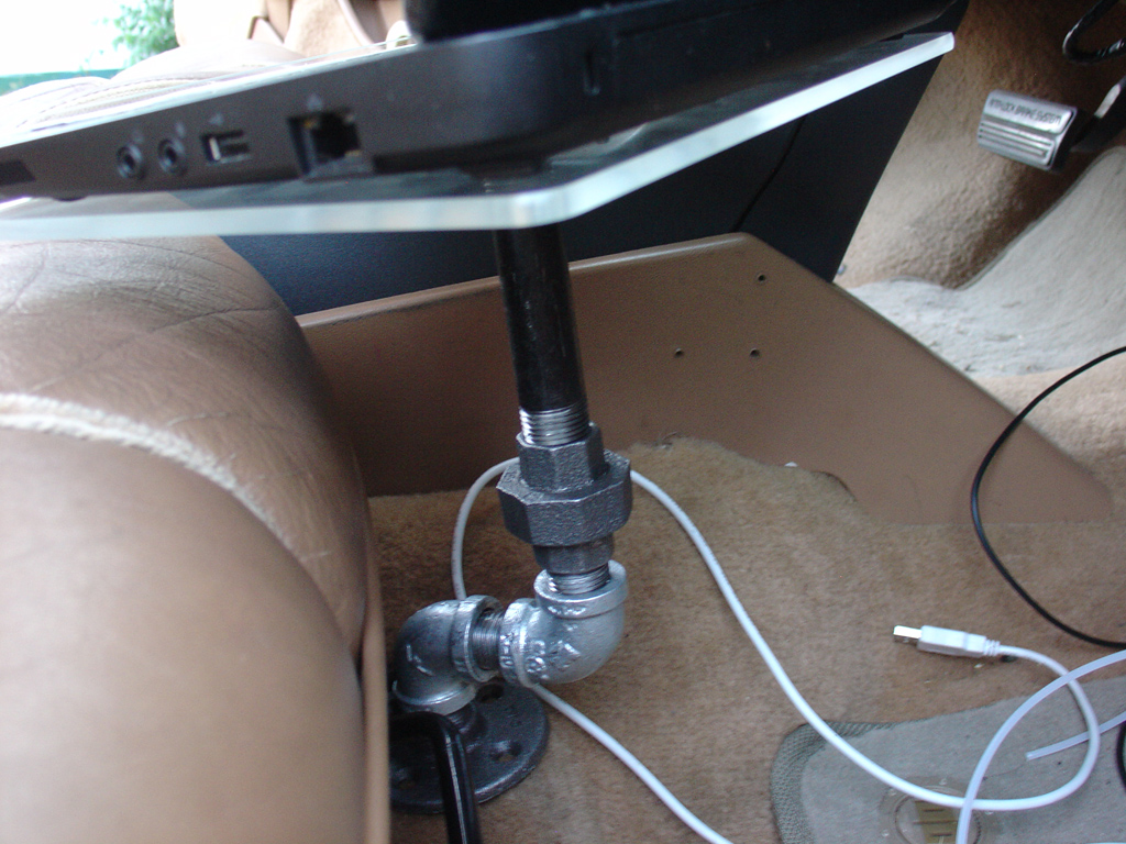

Penglii Posted July 11, 2012 Author Report Posted July 11, 2012 Finally got al the wasps removed from the car! HOORAY!!! OMG I need to wash the car so bad now... I also installed a mount for my netbook. I got the top off of ebay and the rest is made of plumbing stuff from the hardware store. Bolted it onto the passenger seat bolt... seems very sturdy. Holds the laptop in just the right spot for my liking, and it sits low enough that it is very inconspicuous. Only problem is that nobody can sit in the passenger seat if I am using the mount... that's not a big deal though. Utilized a pipe union as a quick release so that I can quickly remove/attach the top half. The tubing prevents the seat from sliding very far forwards... even with the top removed the options are basically "all the way back" or "most of the way back"... but I don't care. If I cared this could be fixed by putting the pipe union at the base instead of in the middle... but I don't care. Now for some pics... Quote

Penglii Posted July 11, 2012 Author Report Posted July 11, 2012 Go right ahead I did not come up with the idea. http://www.mobilelaptopmount.com/placeorder.htm This is the top I got, it fits a 10" netbook perfectly. It came with some fittings, but most of what I used I got for a few bucks at a hardware store. They are just 1/2" steel plumbing pieces. http://www.ebay.com/itm/NETBOOK-LAPTOP-MOUNT-ACER-ASUS-DELL-HP-SAMSUNG-SONY-/150359248552?pt=Computer_Stands_Holders_Car_Mounts&hash=item23021c0ea8 Quote
