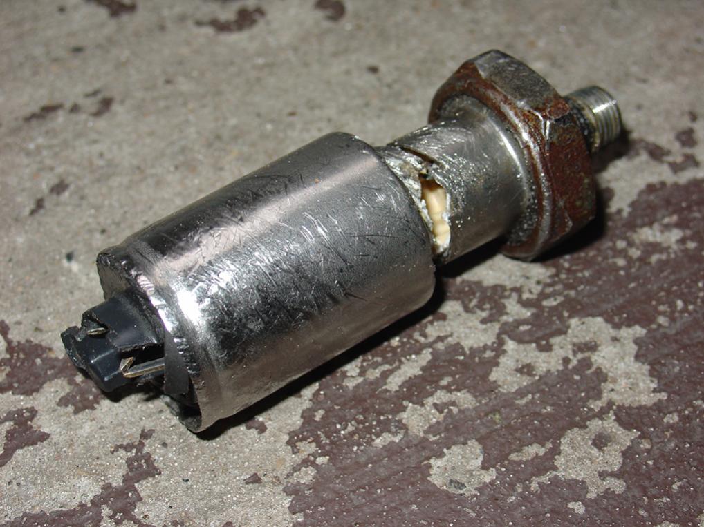

Penglii Posted April 21, 2012 Author Report Posted April 21, 2012 About halfway done with my hacksawing... OMG my hand and arm hurt. This is totally going to work though. Once I crack off the large end of the sensor I am golden. I cannot believe it has come to this to get this hosebeast off the car... This particular oil pressure sensor must have been designed by the same person who engineered the placement of the lower coil pack bolt. Quote
Turbo v-sick Posted April 21, 2012 Report Posted April 21, 2012 I have a socket similar to this in my box. http://www.ebay.com/itm/1-2-Dr-1-3-16-30m-m-x-4-Long-for-Oil-Pressure-Sender-Switch-Socket-/150800000448?pt=Motors_Automotive_Tools&hash=item231c6165c0&vxp=mtr#ht_2595wt_932 Quote
Penglii Posted April 21, 2012 Author Report Posted April 21, 2012 Got it out. It turns out it needed a 1-1/4" socket. Quote

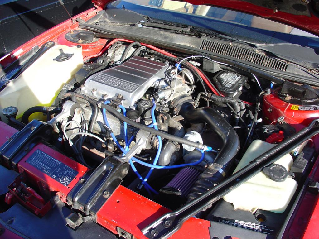

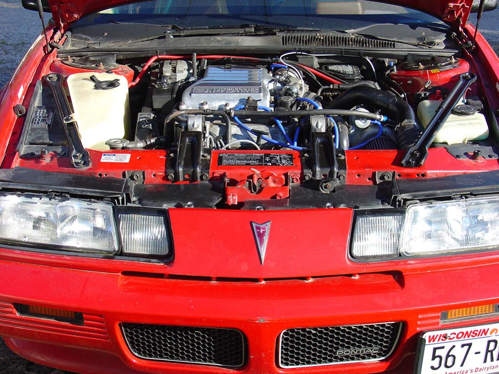

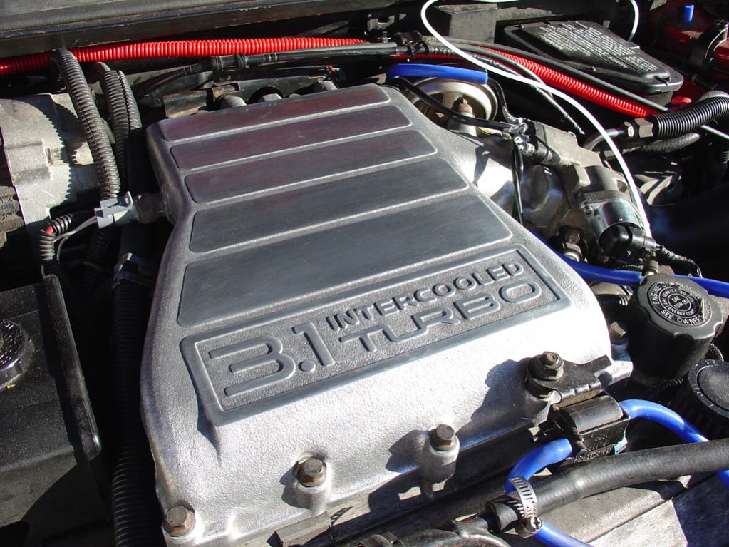

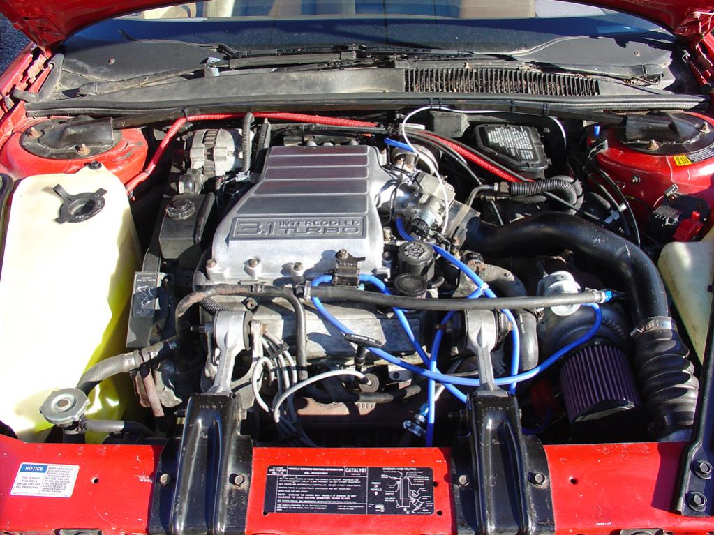

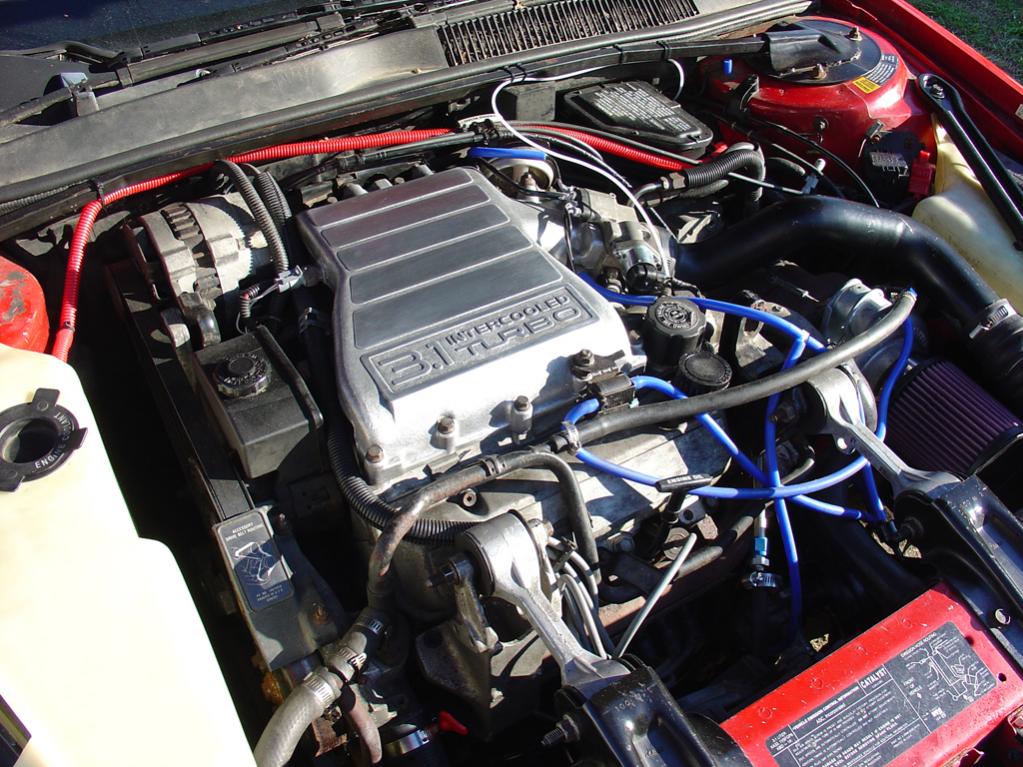

Penglii Posted April 23, 2012 Author Report Posted April 23, 2012 Productive weekend. Got that pesky oil pressure sensor changed out, got the oil changed, refilled the radiator, cleaned most of the paint off the intercooler, cleaned up the intake plenum, got a new battery, put everything back together, and drained so far 5 gallons of old gas from the tank. Hopefully next week sometime I will get to fire her up again and do some datalogging. So totally looking forward to that! I just need to find a buddy to help me bleed the PMIII, that might take some bribery. I also finally took some pictures. Quote

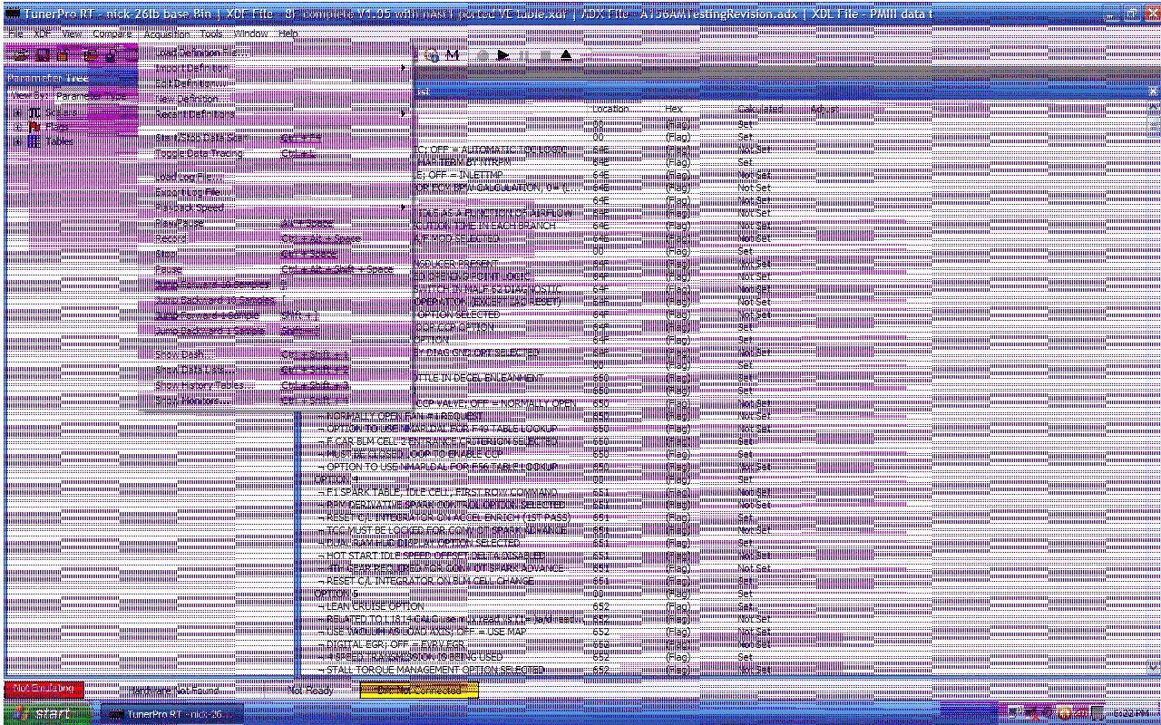

Penglii Posted April 24, 2012 Author Report Posted April 24, 2012 Well now... this will make datalogging significantly more difficult... The screen glitch in my windows laptop got significantly worse apparently. Here is an unmodified screenshot. Quote
Garrett Powered Posted April 25, 2012 Report Posted April 25, 2012 back up everything on a flash drive. Quote
meltboy1 Posted April 25, 2012 Report Posted April 25, 2012 Well now... this will make datalogging significantly more difficult... The screen glitch in my windows laptop got significantly worse apparently. Here is an unmodified screenshot. [ATTACH=CONFIG]8335[/ATTACH] Looks fun... that's an actual screenshot? Quote
Penglii Posted April 25, 2012 Author Report Posted April 25, 2012 Yup... screenshot... which means it's coming out of the graphics circuitry that way. Everything else sill works fine (for now) but doing anything is extremely difficult and headache inducing. I only used that laptop for tunerpro, and I back that data up right away anyway, so there's nothing to lose. I guess I'll have to set up my MacBook to emulate Windows and run Tunerpro that way until I can score another dirt cheap old windows laptop. Quote
