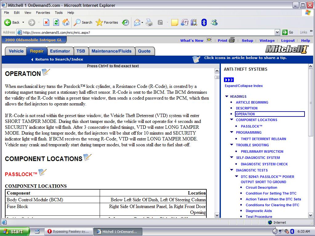

August you are wrong on this the BCM has nothing to do with the PASSKEY in an Intrigue thats actually stored in the ECM. THis is an Intrigue not an Alero. I am unsure if your method works or not as I have never had an issue with any of the Intrigues I have had regarding the PK system other than just replacing the ignition switch which fixed the problem on 3 different cars.
The passlock system in the Intrigue is the same as an Alero, or any other GM of that era, except Cadillacs. The method i listed will work on any Passlock I or II system. PK3, PK3+ and the double encrypted "circle +" keys are differant and that method will not work. But the only w-body to get those systems would be third gen GPs and new Impalas. Im not sure ive ever bypassed the system on a Intrigue, it seems they generally go bad on N-body cars, but as i said the Alero and Intrigue have the same Passlock 2 security system. Swapping out the igniton switch would work also, im just giving him another alternative.
I thought the later GP's got PK3 at the same time the U-vans did.. And I'm pretty positive the Intrigues are PKIII only, but I might be wrong.
00-03 GPs had PK3 keys. '04+ up got PK3+. For some unknown reson 97-99 gps had no security keys, but they did have factory alarms.
