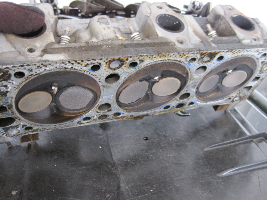

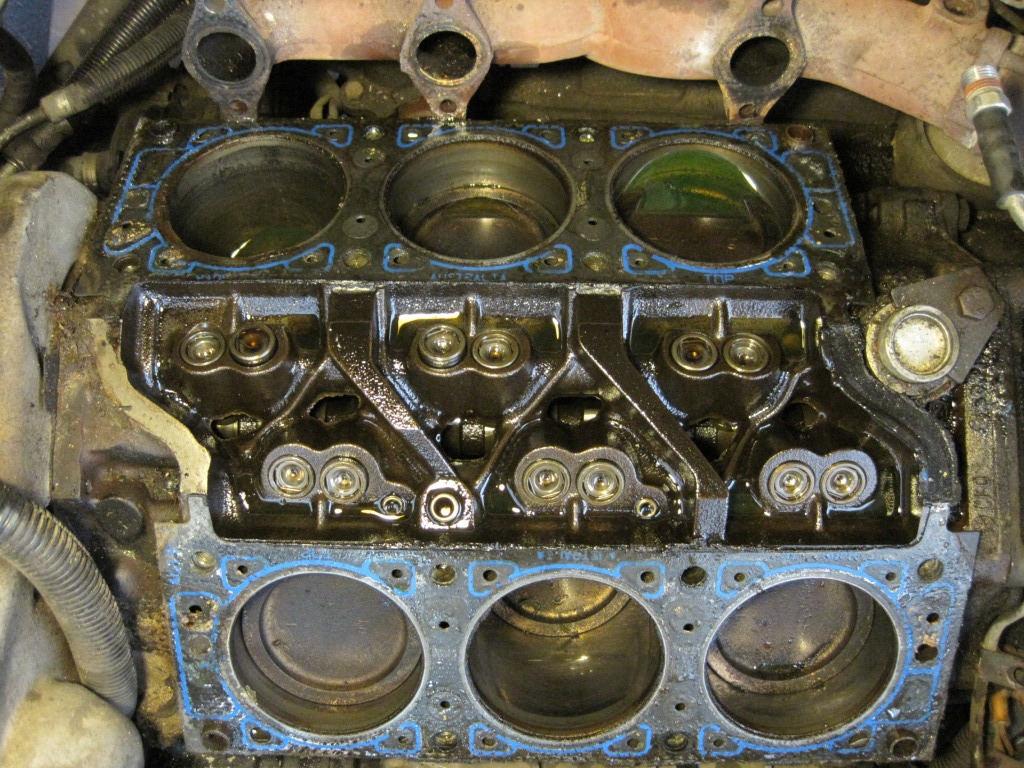

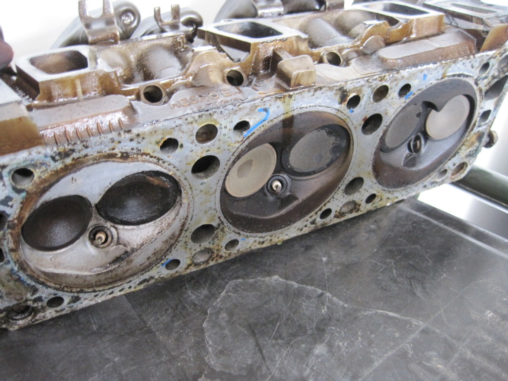

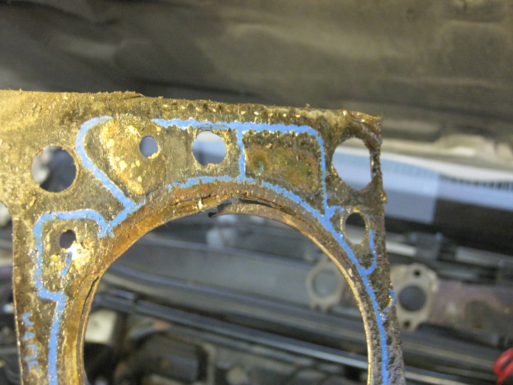

cutlassman Posted May 21, 2010 Author Report Posted May 21, 2010 Just an update incase someone needs this information in the future. I ripped the engine apart...it pissed coolant when I pulled the oil drain plug. The rear head gasket was blown around one cylinder with at least some coolant resting in each cylinder. That explains the hydrolocking. The front head gasket was fine. The block is still filled with coolant, so it doesn't appear to be cracked. The guy at the cylinder shop will resurface both heads after testing, but they don't appear to be warped or cracked. I'll post some pics here of what the rear cylinders look like and the blown head gasket. After getting the heads back next week, I'll begin the assembly process! Quote
tornado_735 Posted May 21, 2010 Report Posted May 21, 2010 What the hell...? I did not know our cylinders were staggered like that. Quote
GnatGoSplat Posted May 21, 2010 Report Posted May 21, 2010 What the hell...? I did not know our cylinders were staggered like that. I think typical V-engine cylinders are all staggered because the piston rods have to connect to separate journals on the crankshaft. Quote
Crazy K Posted May 21, 2010 Report Posted May 21, 2010 What the hell...? I did not know our cylinders were staggered like that. ????? You can;t make an engine that is not staggered... so is the block it good? those don't look like original headgaskets to me... did you have something done previously? Quote
spiderw31 Posted May 21, 2010 Report Posted May 21, 2010 I think typical V-engine cylinders are all staggered because the piston rods have to connect to separate journals on the crankshaft. Correct! And to cutlassman, if coolant came out of the oil pan, I'd be expecting a rod knock sooner rather than later after the repair. Hopefully you get lucky though! Quote

jtwmechanic Posted May 22, 2010 Report Posted May 22, 2010 every v style engine i have ever seen is staggered. hard to put two pistons in the line of 1 rod Quote
tornado_735 Posted May 22, 2010 Report Posted May 22, 2010 IIRC, The cylinders in my Land Rover were not staggered. I could be wrong though. I'll look at the pictures I have. Quote
cutlassman Posted May 22, 2010 Author Report Posted May 22, 2010 The engine is a reman with about seven years/37,000 miles on it. That explains the head gaskets. I'll closely inspect the pushrods and clean the lifters. I haven't done a valve job before, but this probably is a good time to learn. Doesn't seem to be real difficult - unless one of the springs decides to act crazy! I ordered all new gaskets and headbolts and they're all on the way. I guess I'll tackle hand lapping the valves next week. Man, I sure hope all is good after re-assembly! From what I can surmise, I probably only drove the car two miles after the head gasket completely gave way, so hopefully any other damage is limited. From looking at the rear head, the one cylinder was probably taking on at least some coolant for a while, considering how clean the head is in that area. The quick overheating might have been the last straw. However, the oil level was never higher than it should have been...until all hell broke loose. The second picture is of the front head, which looks pretty good - but there really aren't many miles on the engine since the rebuild. Quote
