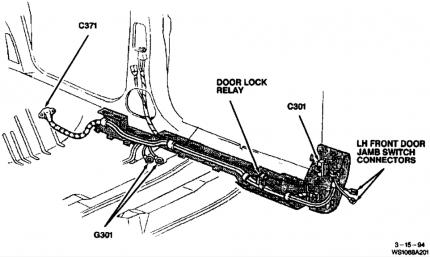

Help with finding the door lock relay?
My service manual says it goes thru the c202 connector which means its somewhere on the steering wheel harness. Anybody know where this mothers at?
it can be in 2 different places. Either drivers side, under the carpet below the parking brake, or passenger side under the glove box.
MY 1988, 1990, 1992, and 1994 all have it under the glove box, my 1996 had it under the parking brake.
I would start where the diagram Robert posted says to go. Its behind the glovebox on my 89, but i dont think its there on the newer GPs.
