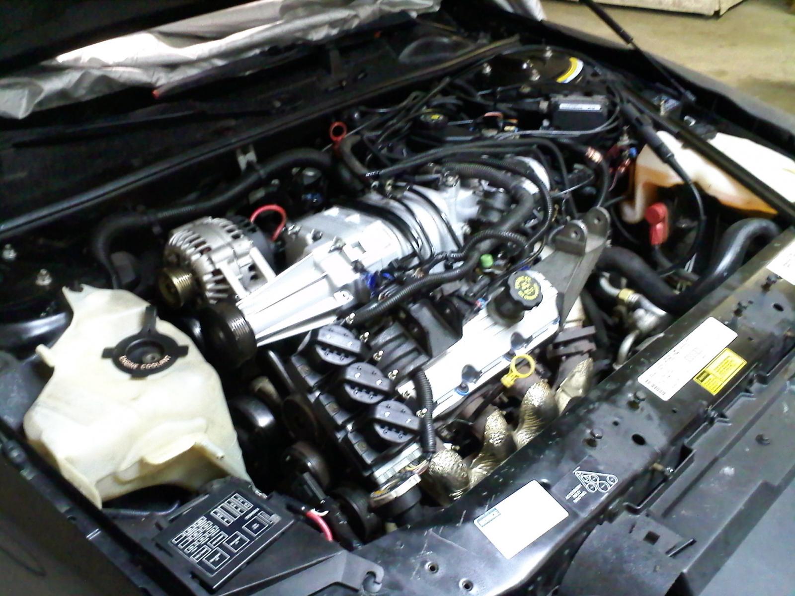

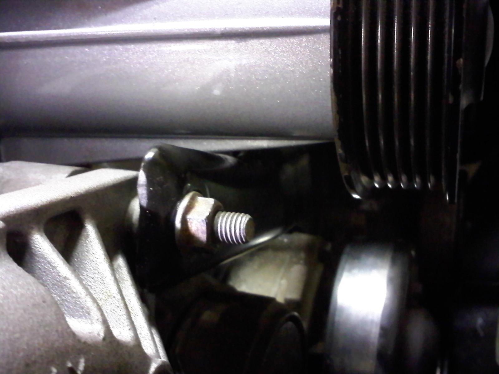

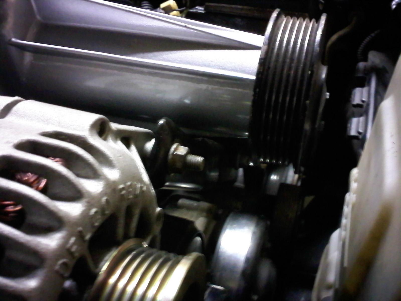

carkhz316 Posted August 21, 2010 Author Report Posted August 21, 2010 (edited) I found some Autolite 104's but of the Iridium variety? Are they worth it at all? Not trying to be an odd duck, lol. Oh and I got my stuff together using my original Alternator brackets, kinds had to persuade stuff to fit: There's a bar that goes on the front and bolts down on the coil pack bracket. Well, it wouldn't initially clear the blower snout, but with a few wacks of a hammer it does. And I have to plug the injectors in on the back side, then bolt that other alty bracket down as there is now room to plug the injectors in once it's bolted down. Everything seems alright so far. Thanks again Addicted to Eaton and AL for sticking with me on this thread.:worshippy: Edited August 21, 2010 by carkhz316 Quote

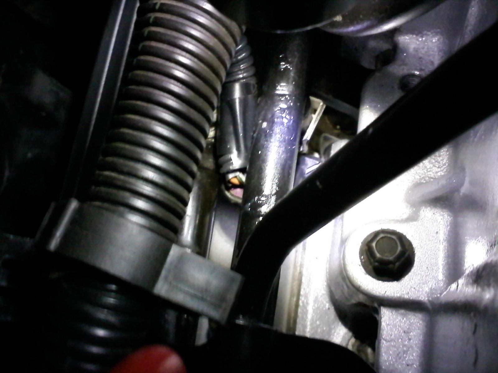

carkhz316 Posted August 21, 2010 Author Report Posted August 21, 2010 Here she is as of today. Just ordered my BBV wire kit thing/ MAP extension and some SC oil from ZZP, also some AL104's and wire set, belts and 180* Stat from RA. Pic 2 and 3 is the bracket that I had to bend a bit to clear the blower snout. Last is the injector buried beneath the fuel rail and back side alty bracket Quote
