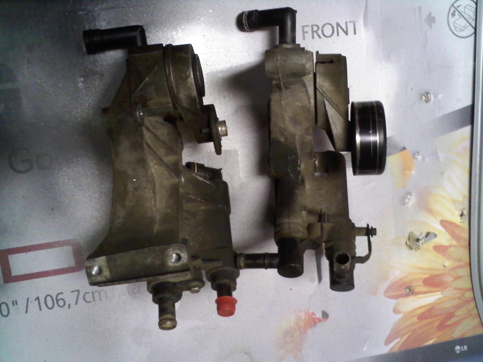

Also, I noticed that the coolant tube/ tensioner/ alternator bracket is different between the donor one and mine. I did a quick test fit of all of my brackets and whatnot and it looks like I use my old setup off my L36, but theres a bracket that bolts onto the rear head near the EGR that doesn't have one of the two bolt holes tapped for this horseshoe shaped bracket. Another bracket bolts to that which bolts to the back side of the alty, essentially performing as a radius arm. After some thinkinng, I thought that I may get away with just bolting the one bolt in to hold the U-shaped bracket down. What are your thoughts?

What I meant by that was that I was referring to the one bracket assembly that the alty bolts to that has the plastic coolant elbow(s) in it is different between the my two engines, which Addicted to Eaton has mentioned is a difference in years. My car and L36 is 98; where my L67 donor is from a 99 GP.

Alright. First is the difference in the tensioner assemblies.

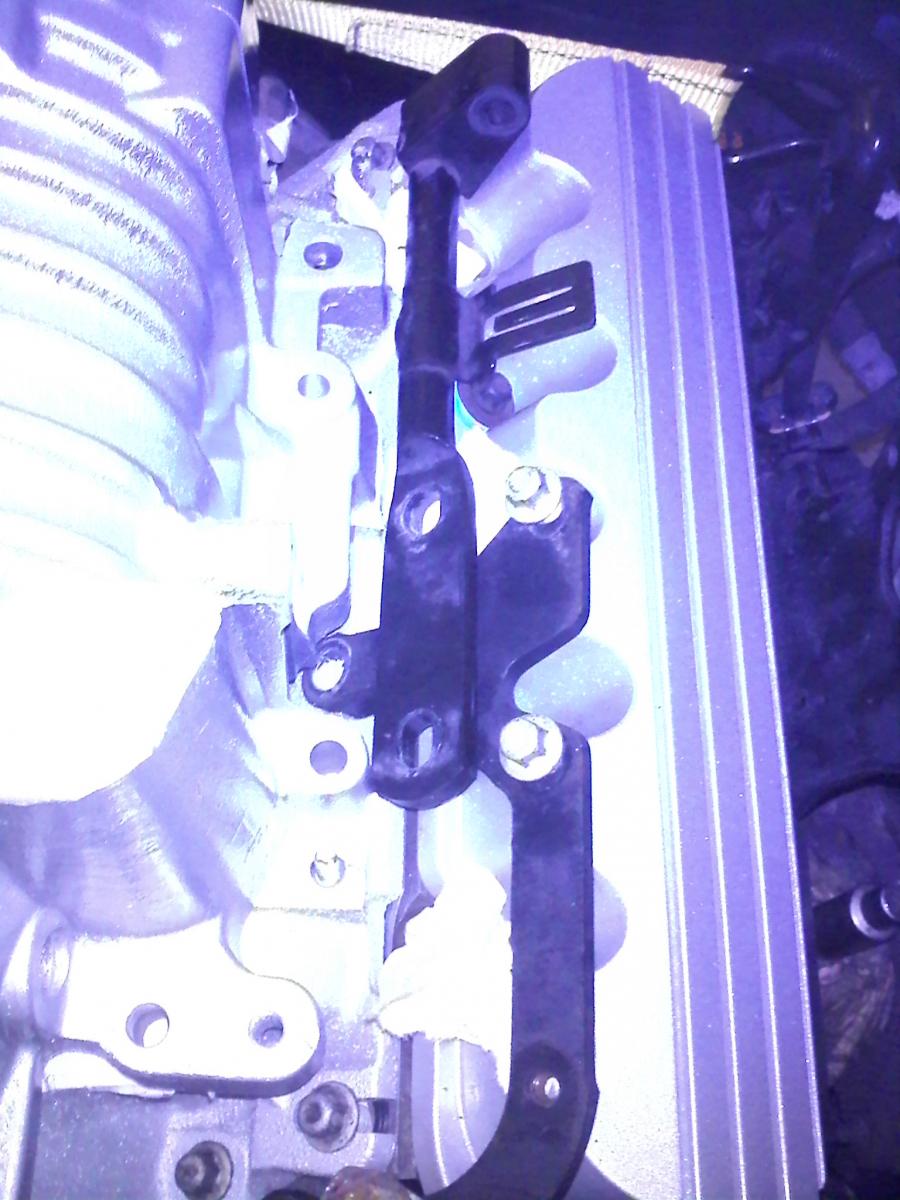

Second is the thing I'm talking about. The extra bracket that bolts to the rear head and and bolts to the back of my 98 and earlier style atly. Where it bolts to the head, there is only one hole tapped, which is the one closer to the EGR. Can I get away with only on bolt holding this bracket to the head?

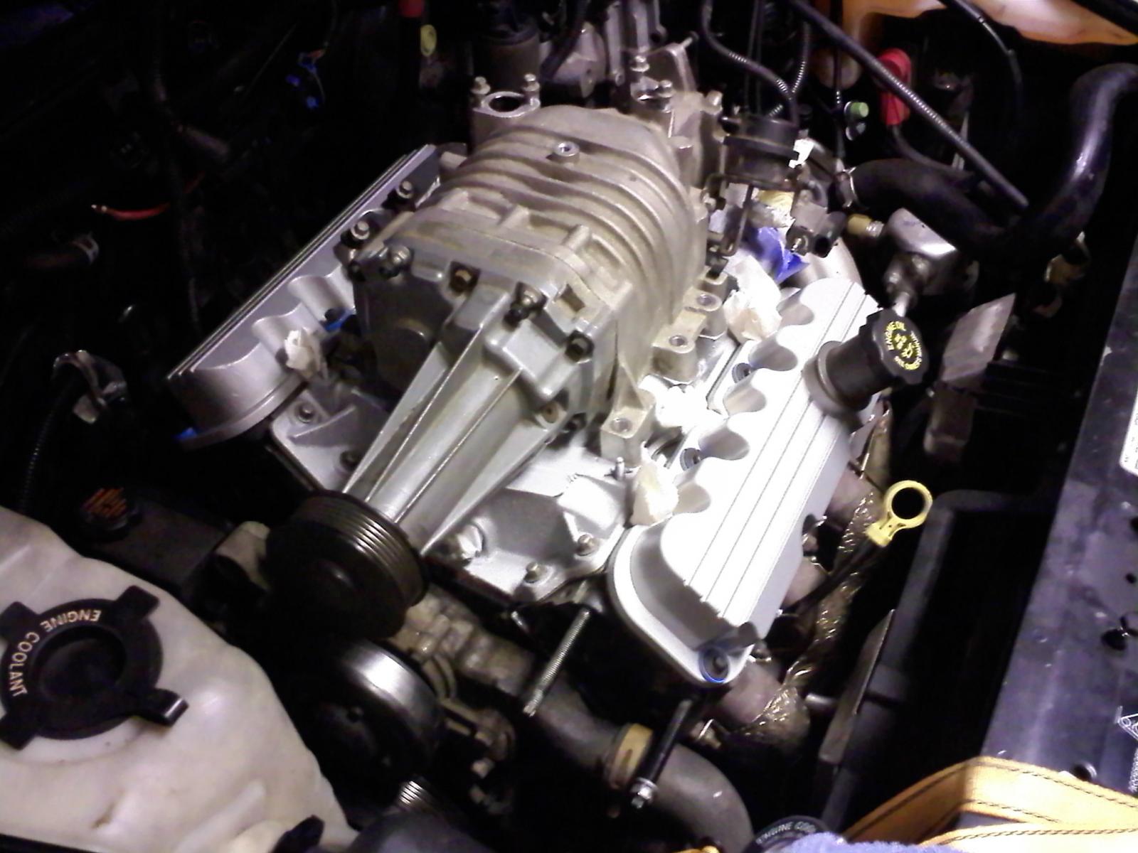

This is where she is at as of the other night, though I have since painted the blower a cast silver color to clean it up (RICCCCEEEEEE) Also, do I need thread lock on the crank balancer bolt? And impact it on alright?

the reason the bracket does not fit, is because it does not belong on any year L67.
Oh it fits just fine. And it will because I've already bolted it down. It's just that one of the two spots for bolts to go in the rear head isn't tapped. If it appears to not be holding the bracket assembly sufficiently with just one bolt, I'll tap the other hole. But let me ask you this, how would I use any of my tensioner assembly/ alty bracket and alternator if this part is integral to my alternator design? I have to use all or none of it, and if I don't, then I've have to get a new alternator as well. But yeah, thank you for the heads up. Makes sense as to why that hole isn't tapped.
But on the other hand, the stand off idler that bolts to the block in the the front already had bolts in it and everything, which I found out double as coolant drain plugs.
i dont see how your fuel rail will fit with that on there ill snap some pictures/Video for you when its light outside.
