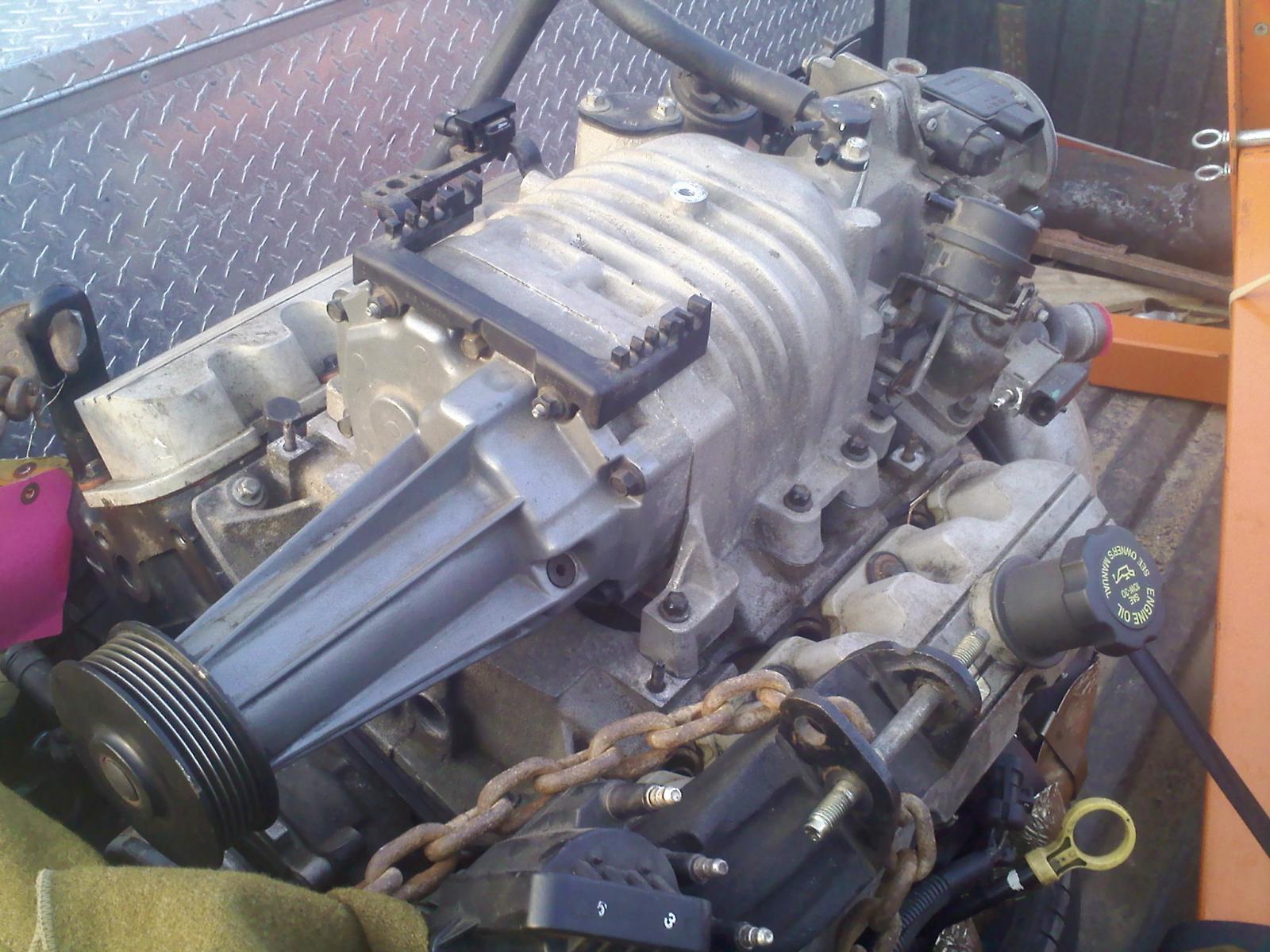

Getting ready to do it finally guys and girls! As I mentioned in bumping my "Want L67" thread, I finally obtained a complete L76 out of a 99 GTP for $150. I got a complete Fel-pro top end gasket set, though I'm ordering the Permadry Plus metal intake gaskets as the kit came with the plastic ones. This project will hopefully initiate very soon, as my wife and I are in the process of buying our first home. (More on that in another thread). I'll have a nice two car, heated/insulated garage to work in now. But yeah, about the engine stuff:

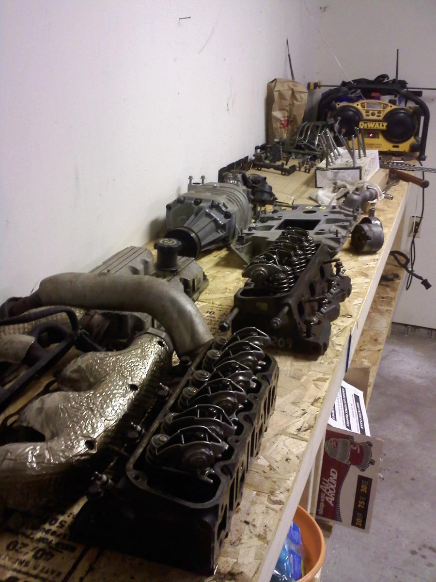

Bump. Got stuffs ripped apart. Heads are off to the machine shop to get checked over for cracks and whatnot.

Update. Had a call last week from the shop. One head (rear bank) had a crack between the seats on one cylinder. Found another pair on CL a small drive from me. Got a 3800performance computer setup for a topswap (pretty sure, or stockish L67) with the heads for $100. Brought the heads in this morning to have them Magnafluxed. Front one had multiple cracks between valve seats. Rear had two, but they were so small, that they could barely be seen even with magnafluxing. Shop guy said they could last a day, or ten years. I know I'm going against good judgement even thinking about using the "bad" one. Are all L67 heads this easily prone to these type of cracks? What have you top-swappers done or what would you do? Anyone have a pair of good ones (or at least the rear bank head)?
Cleaned up most of the rest of the other parts. Want to paint most of it. (I know, RICCCCCCCCCCCEEEEE) But it will either be black or silver for everything from heads on up (minus a polished blower). Have mothers ball; and air drill; will happen. What type of paint have any of you used, or recommend? (I know, high heat engine paint, but particular brands and whatnot)
