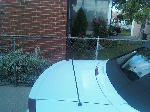

I used a power antenna from a firebird convertible. The bracket was different and took a little adjusting to get it to work.
...mine is angled like the ones on the regal.

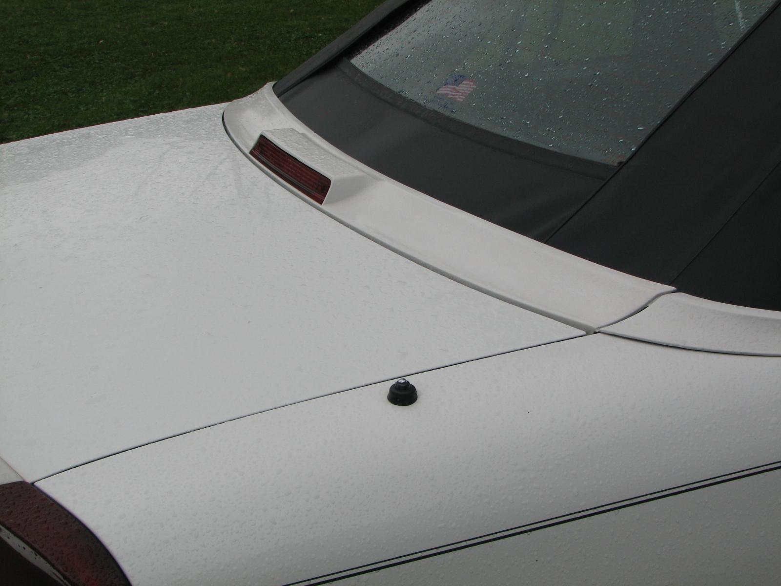

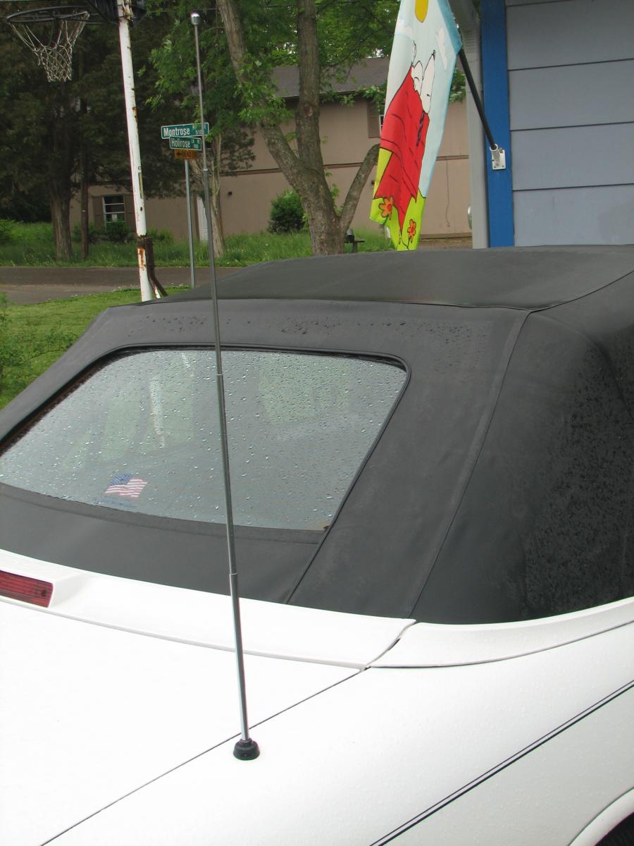

It doesn't look bad, since I post-4483-143689041963_thumb.jpgused the black ferrule from my old antenna, it's not really that noticeable that it's not the correct antenna...
post-4483-143689041951_thumb.jpgTotal cost, $15.00 at the junkyard, and about 2 hour's work...most of which was figuring out how the wiring needed to be done.
