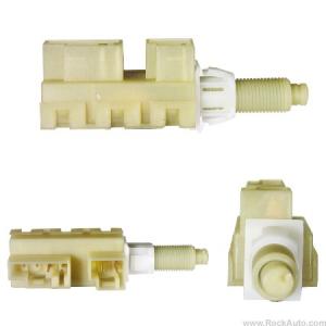

White93z34 Posted April 30, 2010 Report Posted April 30, 2010 try gently pulling up on the brake pedal with your foot while you are at highway speed. your brake/torque converter switch may need adjustment. Quote
BXX Posted May 1, 2010 Report Posted May 1, 2010 Yup, I think I had a thread aboot a month or so ago explaining the situation.. Mine still does this intermittenly. I gotta address it sometime cause its very annoying. Quote
RobertISaar Posted May 1, 2010 Report Posted May 1, 2010 Yup, I think I had a thread aboot a month or so ago explaining the situation.. Mine still does this intermittenly. I gotta address it sometime cause its very annoying. couple of thin layers of tape on the pedal worked for me... i still can't figure out how to adjust the damn switch. Quote

Crazy K Posted May 8, 2010 Report Posted May 8, 2010 Had an issue with my TCC lockup...clipped the PWM wire for the pwm solenoid...details in this thread here: http://www.w-body.com/showthread.php/45252-Lockup-Issues-once-warm? 1995 transmissions seem to have an issue with that particular solenoid? Make sure its not in limp mode, manual downshift to third would result in a downshift, if its already in 3rd then this isn't your issue. Hope it helps I ENDORSE THE PWM WIRE CLIP METHOD. that + cooler and your tranny might work fine... past that come back and detail the issue for further diagnoses. My 95 apparently had a bad solenoid that would quit when hot(another member documented this too). And yet another member(Buick bob??) had a bad or maladjusted Neutral safety switch that kept O/D from working. The brake switch, if it in the simple: can usually just be pushed in and out as the tangs that hold it allow it to be forced. If necessary, you can unhook the wires and screw it in or out if it does not budge. Quote

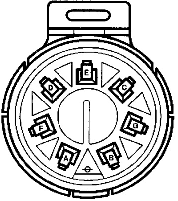

jesterx888 Posted May 8, 2010 Author Report Posted May 8, 2010 Does anyone have any pics of the pwm harness and which wire to clip for sure? Quote
RobertISaar Posted May 8, 2010 Report Posted May 8, 2010 the brown wire in position C of the round 7 position trans connector is for PWM operation. Quote
jesterx888 Posted May 8, 2010 Author Report Posted May 8, 2010 the brown wire in position C of the round 7 position trans connector is for PWM operation. Sweet thank you. Is this on the back side of the trans? Quote
mfewtrail Posted May 9, 2010 Report Posted May 9, 2010 Just remove the wire from the trans connector, there's no need to actually cut it. It literally takes a few seconds to unplug the connector, take it apart, and remove a wire from it. Quote
jesterx888 Posted May 13, 2010 Author Report Posted May 13, 2010 Well, I disconnected the brown wire at pin C and now my check engine light is on.... I didnt have time to see if it fixed my trans issue so I will see how it acts when I go to work Quote
