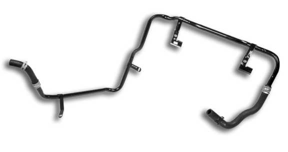

99screaminregal Posted April 19, 2010 Report Posted April 19, 2010 Ok, as we all know, the heater core pipe on the LQ1 was a piece of shit. Mine finally rusted through and I cut the piece of the pipe out and put a piece of rubber hose in and slabbed the hell outta the ends with RTV. Still leaks............. Went on AZ, Napa, Advance sites and found the replacement on Napa's site . Application says for the 3.1..... Looks just like what I have though. Will it work??? I'll just print a picture off for now and look at it when I get to work on it today. If so, and I bought it, what would be the best way to keep this from rusting out?? Could I spray some underbody coating on it and keep the moisture off the outter metal? Quote
White93z34 Posted April 19, 2010 Report Posted April 19, 2010 I had no idea that they even made new ones. Picture of it? I would just spray it with a good rust preventive paint like rustoliem. not too much we can do in northern climates about it. Quote
99screaminregal Posted April 19, 2010 Author Report Posted April 19, 2010 Here it is Balkamp PN# BK 8111412 I can has new by tomorrow, I KNOW RIGHT? Quote
White93z34 Posted April 19, 2010 Report Posted April 19, 2010 Figures it would be a NAPA part, they carry the most odd shit. I'll have to pick up one for my GP Quote
99screaminregal Posted April 19, 2010 Author Report Posted April 19, 2010 Yeah, that's why I always have them on speed dial. So, does it look like it will fit the LQ1? Quote
White93z34 Posted April 19, 2010 Report Posted April 19, 2010 yeah it looks like it should work. Quote

mra32 Posted April 20, 2010 Report Posted April 20, 2010 I just got the old 6' length of heater hose and replaced the leaky one. Looks factory enough and was only $6 or something like that. Replaced it a few minutes after buying it. Quote
