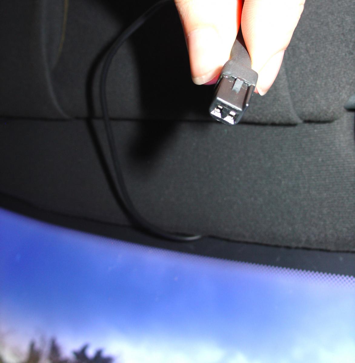

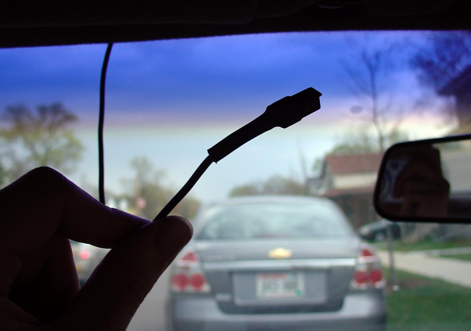

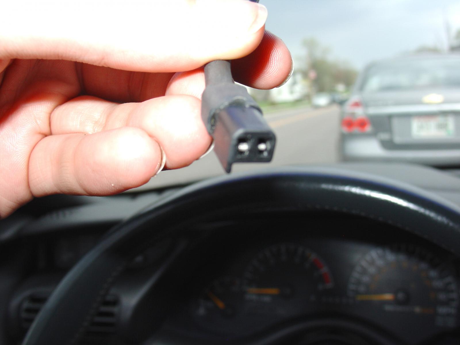

Penglii Posted April 16, 2010 Report Posted April 16, 2010 There is this power connection coming out of my headliner. My first thought was that it could run power to a auto-dimming mirror, but the plug doesnt fit a mirror... Also the line gets no power (tested with a voltmeter)... so I wonder what it is/was/should be connected to at the other end. I'd rather not remove the headliner to find out though... Any ideas? Quote

Penglii Posted April 16, 2010 Author Report Posted April 16, 2010 I had one of those too. Maybe someone before you had a radar detector. Did you ever know where yours was connected to? I'm thinking it runs to either the dome light or maybe the map light... and just has a short? Quote

Crazy K Posted April 17, 2010 Report Posted April 17, 2010 that is NOT, I repeat NOT a factory plug. I have messed with sunroofs, installed several autodimming mirrors, installed several overhead consoles... and it is NOT one of the connectors for any of those. PERIOD. I see that the back half of the connector seems to be wrapped with heat shrink tubing. that would be very typical for an aftermarket device such as a carphone. I would bet that it once had an antennae or a microphone attached to it. therefore, disregard it and tuck it out of view for perpetuality, or trace and remove it. However!!!!!! if you DO wish to install a auto dimming mirror.. ( or are you going for a typical one with maplights?) the wires are VERY easy to install, and require a little bit of work to do. A word of warning: the maplight mirror MUST be attached to a "switchable" circuit, which is one that is powered only when the car is on... unless you like a dead battery the first time you don't drive the car in a day... If you tell us what you wish to do, I or someone else can explain how you would best do it. Quote
GnatGoSplat Posted April 17, 2010 Report Posted April 17, 2010 Yeah, I checked my spare visor and it's definitely not the light for that (only 1 wire) and definitely not for the overhead console (3-wires). Heatshrink and 1 single physical cable tells me that may be a shielded cable. If so, those are typically used for something like an antenna or microphone. Perhaps that car had some kind of hands-free car kit. Quote
