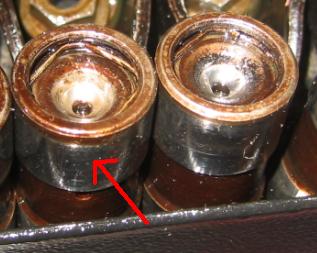

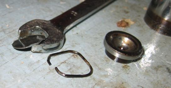

Pabz Posted April 22, 2010 Report Posted April 22, 2010 (edited) After I overhauled my 2.8 in the cutlass due to a broken head bolt the antifreeze gummed up the lifters. I didn't know that it happened until after the engine was assembled. I had major ticking that increased at higher revs. Turned out the lifter was stuck or busted. I would replace them. Here is a pic of the damage. and a link to my project photo album http://www.ece.ualberta.ca/~ployola/W-body/BrokenHeadBolt/ here is a link to my lifter tick video, It doesn't sound like yours though http://www.ece.ualberta.ca/~ployola/W-body/MVI_9654.AVI Edited April 22, 2010 by Pabz Quote

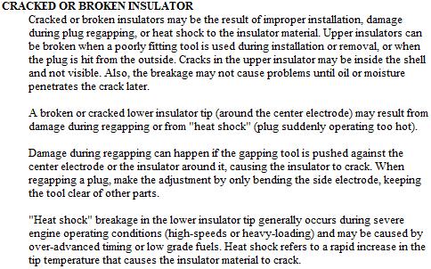

RobertISaar Posted April 22, 2010 Report Posted April 22, 2010 (edited) ALLDATA comes through... does this sound about right? EDIT: i hate the resizing crap... this one is JPG, but shouldn't be smaller than intended. Edited April 22, 2010 by RobertISaar Quote

xtremerevolution Posted April 22, 2010 Author Report Posted April 22, 2010 Sounds like it happened going up the mountain in colo! Sure does sound like it! BTW, I can't see that picture. Work blocks lots of websites here, especially photobucket, but surprisingly, not facebook. Quote
RobertISaar Posted April 22, 2010 Report Posted April 22, 2010 Sure does sound like it! BTW, I can't see that picture. Work blocks lots of websites here, especially photobucket, but surprisingly, not facebook. did you check the EDIT? i added a full-size JPG. Quote
