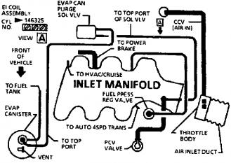

I don't think there are that many either... but it is hard to estimate their lengths without removing them from the car.
i may not be able to give you an estimate, but this should give you a good idea where to look to measure for yourself.
