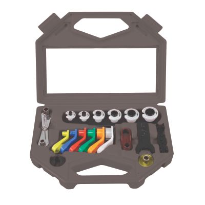

Penglii Posted April 7, 2010 Report Posted April 7, 2010 I want to get the correct tools for disconnecting and reconnecting all the fuel lines on my 94 3100, so that I can replace the tank/filter/etc without having to mangle anything by using the incorrect tool. I understand that a 20mm open end wrench and a 5/8" flare nut wrench are helpful. What about those brightly colored plastic quick-connect fitting tools they make? I see they come in a bunch of shapes & sizes... which ones are good for the w-bodys? Thanks! Quote

spiderw31 Posted April 7, 2010 Report Posted April 7, 2010 ^ That's the way to go. I tried the colored plastic ones, and they are hit or miss. I don't recommend them. Quote

Addicted to eaton Posted April 8, 2010 Report Posted April 8, 2010 i have used the little ones for sale for just a buck or two with Very good results. The person behind the counter should tell you what one you need. (mine was a yellow one) Quote
BXX Posted April 8, 2010 Report Posted April 8, 2010 I have the kit pictured above. Very helpful to have if you ever work on other vehicles too. Quote
Biohazed Posted April 8, 2010 Report Posted April 8, 2010 i have used the little ones for sale for just a buck or two with Very good results. The person behind the counter should tell you what one you need. (mine was a yellow one) I have that same kit but it's in a Gray case and says Blue Point and cost me $60 lol Quote
