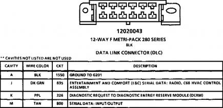

RobertISaar Posted March 31, 2010 Report Posted March 31, 2010 i'm seeing 4 pins populated in the 94 cutty ALDL plug... ground serial E&C diagnostic request you MIGHT be able to use the paperclip trick... Quote

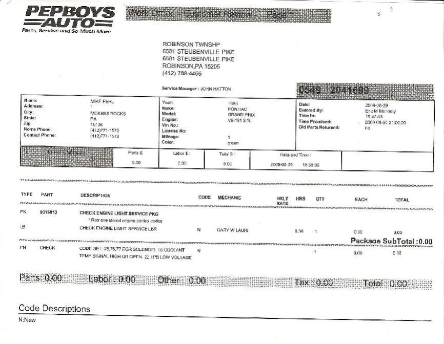

WhatTheFehl Posted March 31, 2010 Report Posted March 31, 2010 Nate, that above procedure will not work. Being a 94, your car (like mine) is OBD1.5, sort of the bastard child between OBD1 and OBD2. It is nigh impossible to obtain the codes without having a stealer get them, and if I remember, someone just paid a stealership $80 to do so. About the best thing you can do is start changing sensors and see if one of them causes it to go out. Good luck buddy. My local PepBoys will scan your codes and tell you the problems for free. I have the printout somewhere that they gave me when I took the car there a few months ago... Quote
94 olds vert Posted March 31, 2010 Author Report Posted March 31, 2010 I wonder if my pep boys will do that for me. Spark plugs are done. Going to try to do the o2 sensor. It should be running really good after all of that. If the light is still on I will drive it up to pep boys after school tomorrow. Quote
WhatTheFehl Posted March 31, 2010 Report Posted March 31, 2010 Go for it. I would assume every PepBoys location has the service for free. Quote

WhatTheFehl Posted April 1, 2010 Report Posted April 1, 2010 If your PepBoys will read the codes for free like mine does, I say do it. Its better to know what it has and have it be nothing, than to not know what it is and have it be a future problem... Quote
slick Posted April 2, 2010 Report Posted April 2, 2010 To keep on with the Connector subject, riddle me this: Curiousity got the best of me. I have two OBD2 scanners, both of which are decent quality. Knowing that the Regal (1995 keep that in mind) is OBD 1.5, and some OBD 2 readers can read OBD 1.5, I went outside, scanners in hand, to find out. Look under the dash, and right in my face is a OBD 1 CONNECTOR. WTF?! I am with 10000% certainty that this car has never been modified. Now, I did not have enough time to jot down the pin locations, however there were not pins in the typical A & B slots that OBD 1 guys can use the paper clip trick on. I'll get pictures tomorrow, along with pin location. What in the hell is going on here? Quote
94 olds vert Posted April 2, 2010 Author Report Posted April 2, 2010 My Light went off when I pulled it into the garage tonight. I shut it off and started it back up to make sure and it stayed off. Quote
RobertISaar Posted April 2, 2010 Report Posted April 2, 2010 To keep on with the Connector subject, riddle me this: Curiousity got the best of me. I have two OBD2 scanners, both of which are decent quality. Knowing that the Regal (1995 keep that in mind) is OBD 1.5, and some OBD 2 readers can read OBD 1.5, I went outside, scanners in hand, to find out. Look under the dash, and right in my face is a OBD 1 CONNECTOR. WTF?! I am with 10000% certainty that this car has never been modified. Now, I did not have enough time to jot down the pin locations, however there were not pins in the typical A & B slots that OBD 1 guys can use the paper clip trick on. I'll get pictures tomorrow, along with pin location. What in the hell is going on here? late 95 cars got the OBD2 connector from what i can tell. i know the MC was a fairly early one in the production, so i lucked out and got the OBD1 connector... the only difference is physical, it's essentially the same thing, just a bigger pain in the ass to deal with. aldlcable.com sells a "OBD2" ALDL cable specifically because of this. mind you the cable won't work with actual OBD2 cars, just OBD1 cars with the OBD2 connector... inconsistency and GM are two VERY like things... Quote
