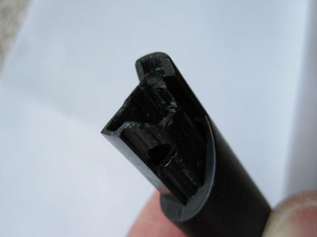

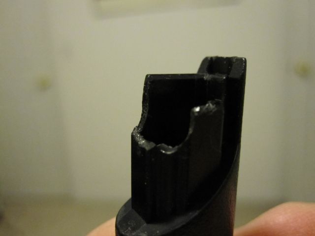

GnatGoSplat Posted May 24, 2010 Report Posted May 24, 2010 Heheh, I successfully repaired my hazard button and attached before & after pics. I am either unusually resourceful or insanely cheap depending on your point of view. I had no idea what the missing chunk of it looked like so I had to guess. It works perfectly and snaps snugly into place with a "click" because I drilled a detent into my fabricated side similar to where the hole is on the other side. Quote
