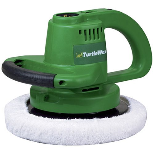

warwgn3 Posted March 22, 2010 Report Posted March 22, 2010 About 7 years ago when I had my old wagon, I spent 8 hours waxing it by hand.... after that I said "fuck this" and I got a Turtle Wax 10" orbital buffer for $50 at Wal-Mart, and still works great. The only downsides are that it's too big to get the small intricate spots, like the plastic bumper fillers, and the vibrations tend to lead to the power cord falling off, and gets rather annoying. Quote
LuminaPower92 Posted March 22, 2010 Report Posted March 22, 2010 That is more of an orbital for removing light swirls and wax. I use @ work a Dewalt Heavy duty polisher Dw847. Depending on how bad of shape the paint is i have a double sided wool pad to cut and some double sided blue waffle pads to polish out the swirls after compounding. Works wonders. I also use 3m Compound to Buff, and use a local Ardex brand swirl remover then follow up with wax. Quote
