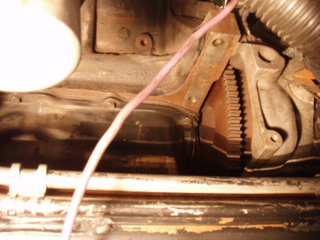

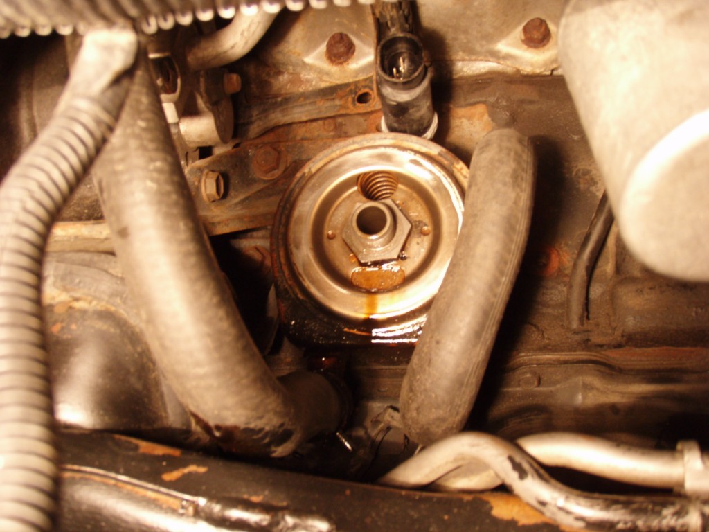

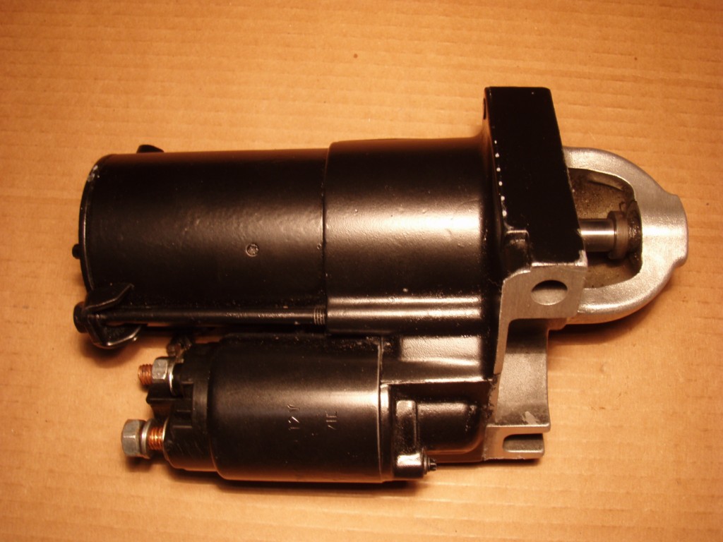

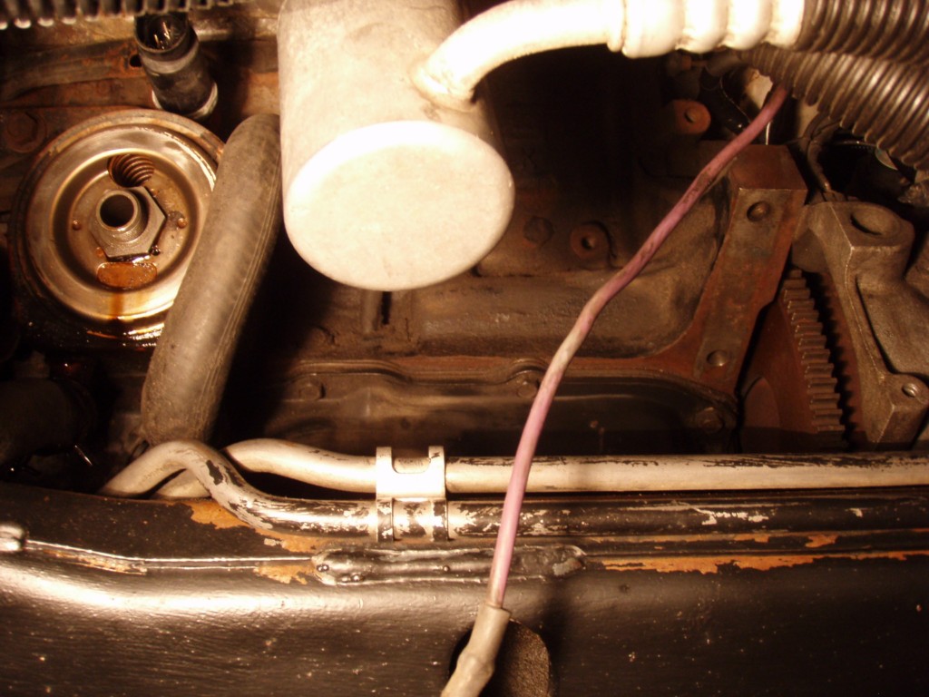

GTP091 Posted March 25, 2010 Author Report Posted March 25, 2010 (edited) I was able to get the starter out in about 2 minutes after giving it another try. I gave it the lift, twist, and turn and it came right out. Looks like another reason GM charges to much to do this kind of stuff when their service manual tells them to take off more than whats needed. I didn't need to pull the oil cooler to get it out or disconnect the coolant lines either. Reminded me when I was quoted 8 hrs to change the alternator. I did that in 1.5. The starter I found was in a 03' Pontiac montana and was the only 3400 in the entire yard. The starter is in real good shape of course I'm going to repaint it so will have pics of it installed then. Here's some pics of the hole it left and a side by side of both units. There's one shot where you can see the void left when you remove the ignition pack and another of the oil cooler itself. Edited April 5, 2010 by GTP091 Quote

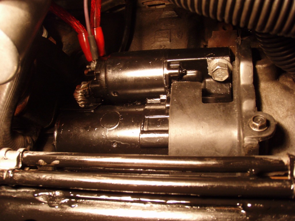

GTP091 Posted April 5, 2010 Author Report Posted April 5, 2010 Here's the final shots of the starter in the car. You can see how much smaller the starter is compared to the original; the old starter was backed right up to the coolant hose of the oil cooler. It now starts with much more gusto and seems to crank at a higher RPM as well. I cleaned the mating surfaces and spread a thin film of dielectric grease on it to make sure it was grounded well. Quote
