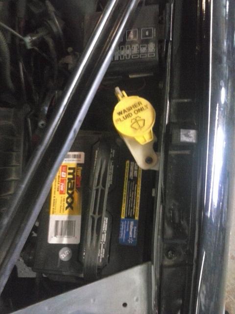

This came from I think a kia spectra, it had the pump in the bottom and fit well inside the fender, but I did have to relocate my vacuum ball. It shares that fender with the ugly ass cruise control box that's been banished to the fender as well.

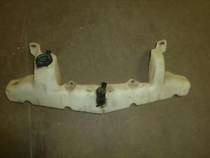

Does anyone have a picture or part number for swapping in the third generation F-Body washer fluid reservoir?
You would just go to the junkyard and get it, although I'm not sure of it being from a 3rd gen. It was the 4th gen that had it in the bumper. Check the upload. It comes in Camaros from 1993-2002.
