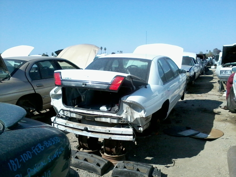

1979lee Posted March 29, 2011 Author Report Posted March 29, 2011 I know this is an old post. but i am finally getting around to doing this to my lumina I can get the pipes to do this from the JY, for 25.00$$ but will the ones off of a monte carlo work? thanks Quote
94 olds vert Posted March 29, 2011 Report Posted March 29, 2011 Monte Carlo/= Lumina 2 door/ 4 door Yes, they will work. I assume its a 95-99 monte carlo? Quote
1979lee Posted March 29, 2011 Author Report Posted March 29, 2011 Monte Carlo/= Lumina 2 door/ 4 door Yes, they will work. I assume its a 95-99 monte carlo? Thanks, i kina figured that, but i didnt want to buy them and have it not work. THanks again Quote
1979lee Posted March 29, 2011 Author Report Posted March 29, 2011 I assume its a 95-99 monte carlo? Yes Quote
94 olds vert Posted March 29, 2011 Report Posted March 29, 2011 The 95-99 monte carlo will work.. Just grab the mounting stuff as they may be different since you are adding another muffler. Quote
1979lee Posted March 29, 2011 Author Report Posted March 29, 2011 The 95-99 monte carlo will work.. Just grab the mounting stuff as they may be different since you are adding another muffler. I will, i grabbed the front brake rotors off of it today, it had a 3800 v6 does that matter? it looked quite east to remove the pipes and ect., just 2 bolts near the cat, (which some fool had replaced with a muffler). ive wanted to do the for some time now, my muffler is about shot, it make a poping noise as it cools off (only in winter). thanks again. this is gonna my fun!! Quote
94 olds vert Posted March 29, 2011 Report Posted March 29, 2011 The fact that is has the 3800 shouldn't make any difference. Quote
3pt1lumina Posted March 29, 2011 Report Posted March 29, 2011 Yes, and as 94oldvert said, grab the mounts from the driver's side. You will need those. It's held in with 2 bolts IIRC. Quote
94 olds vert Posted March 29, 2011 Report Posted March 29, 2011 Yup that's right two bolts one on the muffler and one on the bumper support. Quote
1979lee Posted March 30, 2011 Author Report Posted March 30, 2011 Yup that's right two bolts one on the muffler and one on the bumper support. Looked around under the my lumina last night, the drivers side had the ccorrect bolts. Ill grab all the stuff y'all mentioned. ive wanted to add this to the car for a long time,just never had the time to do it. thanks again Quote

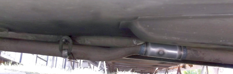

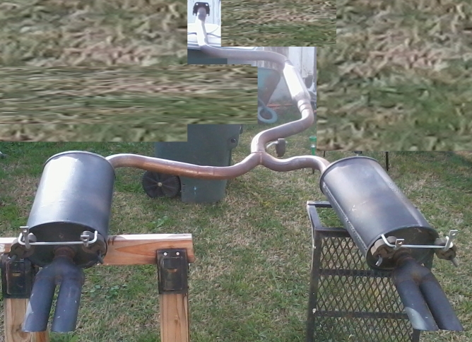

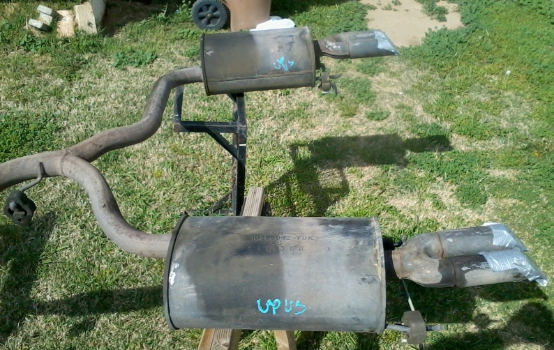

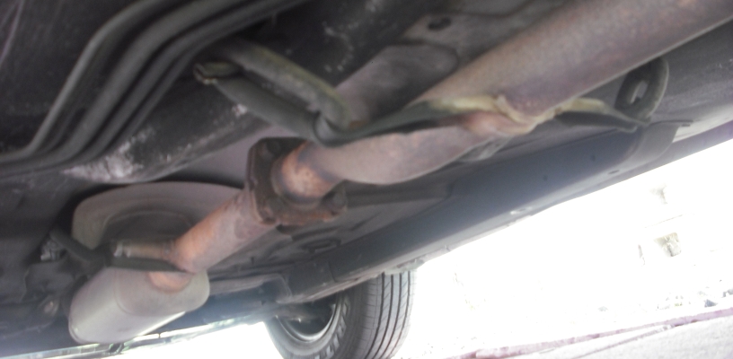

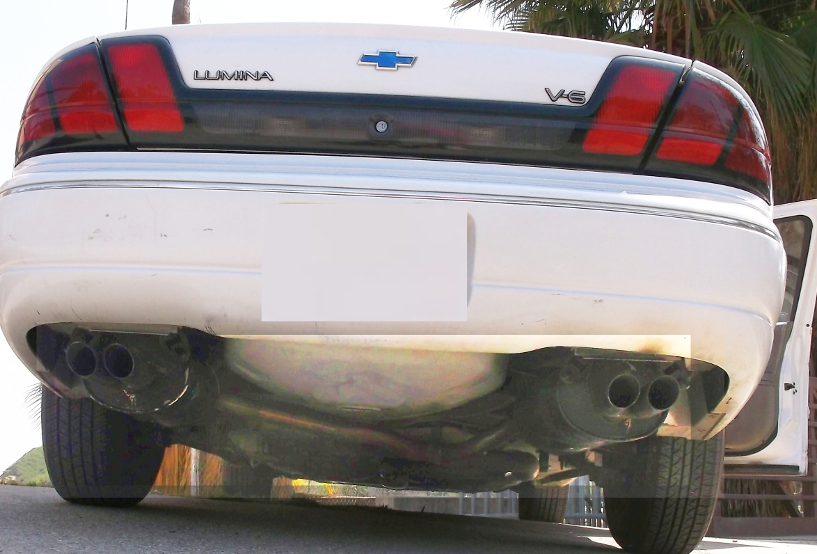

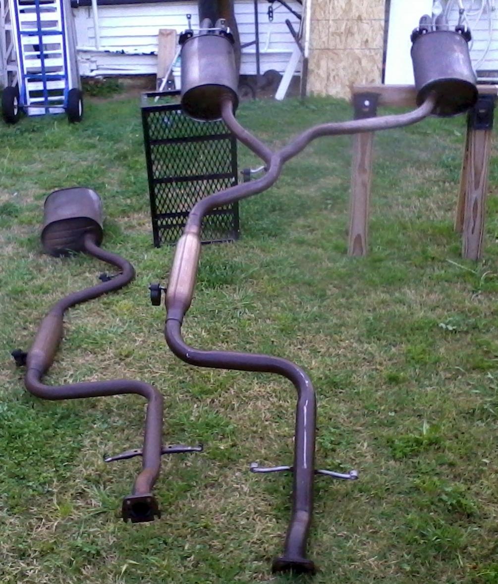

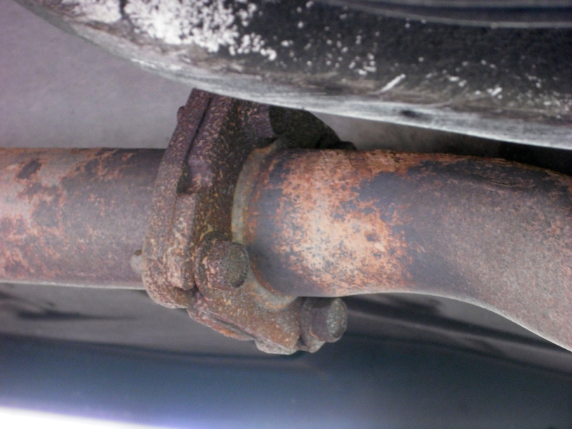

1979lee Posted April 10, 2013 Author Report Posted April 10, 2013 (edited) Well i Finally Did it! Last week I Installed the dual's off of a 96 lumina ls, with the dohc 3400 engine, the flange to the cat did NOT match, did not bolt up(pipe size is larger on doch 3.4's) , so i had to have the flange cut out and a pipe welded in its place see pics. i painted the mufflers with high temp 1200 degrees bbq paint, semigloss. looks nice. has a nice rumble, very quiet though. totally different sound. nice. i didnt this i was going to be able to remove the flange bolts, alnost RUSTED on... and this is a salt free california car... it does seems to run better, and its feels quicker. mpg's Who knows.... thanks all. Edited August 13, 2013 by 1979lee Quote
MonteCarloDude Posted April 10, 2013 Report Posted April 10, 2013 Very nice! I need to do this someday. Also, it seems on the first page I had a typing error from years ago. Oops. Quote
