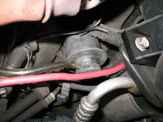

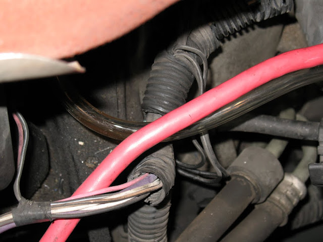

cutlasssupremeking Posted November 25, 2009 Report Posted November 25, 2009 I was wondering if this was the Fuel Pressure Regulator? I , in a previous topic, was recommended to replace my Fuel Pressure Regulator. I don't know where it is or how to get it off. I have some picture of what I think is the Fuel Pressure Regulator. Am I right? This picture below is a shot of gasoline in my vacuum tube. Quote

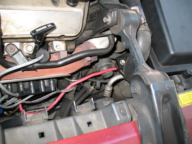

Regal_GS_1989 Posted November 25, 2009 Report Posted November 25, 2009 That would be the Vacuum modulator for the Transmission. It's been a while since I've been under the hood of a 3.1, but it should be visible through the opening under the plenum near the throttle body. There should be 3 vacuum lines coming off of the Throttle body, and one will run just under the plenum and connect to it. It will be on the fuel rail. Hopefully you can figure that out from my vague description Quote
Regal_GS_1989 Posted November 25, 2009 Report Posted November 25, 2009 Should be this guy right there. Look where I put the red box... Quote

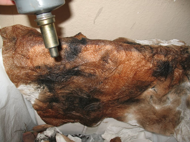

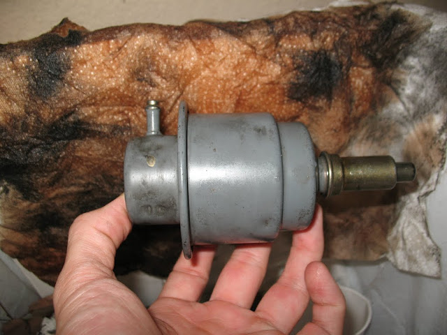

cutlasssupremeking Posted November 26, 2009 Author Report Posted November 26, 2009 So, I pulled out the part in question and oily liquid came out. That didn't seem right to me, so I kept shaking the module to get the rest of the oily liquid out. I thought it was a mixture of gas and oil. But, not that this part has been properly identified as a Transmission Vacuum Modulator, I know that the liquid was transmission fluid. I was wondering why the liquid was reddish! But, there was a lot of fluid that came out of the Module. Is this normal? See the picture below(that's a whole piece of paper towel that is soaked by how much transmission fluid came out). I think there is something wrong because I keep getting transmission fluid in my hose... These things are pretty cheap, so I am going to buy a new one tomorrow, but the question still stands; Is it normal to have that much transmission fluid in there? Quote
RobertISaar Posted November 27, 2009 Report Posted November 27, 2009 if any of it came out of the vacuum half: something's wrong. the actual half that goes in the tranny: i'd call it normal, but the fluid looks dirty as hell Quote
hotrodolds Posted November 27, 2009 Report Posted November 27, 2009 Yeah, you'll need to replace that. That's the vacuum pressure regulator for the trans. The fuel pressure regulator is under the intake plenum. Quote
Regal_GS_1989 Posted November 27, 2009 Report Posted November 27, 2009 No, that is not normal. I pulled mine out for the hell of it one time, and other then a slight residue on the plunger part, there was no oil. When the modulator goes bad, it can start sucking fluid up through the vacuum and actually start burning it through the engine. I would be willing to put money on the transmission shifting kind of hard and rough, especially when it downshifts into first. And yes... the fluid does look dirty...but not too bad. You should be fine just doing a pan drop/filter change. The plus side...ATF kind of works like seafoam...so any trans fluid being burned should have done some top end cleaning Quote
