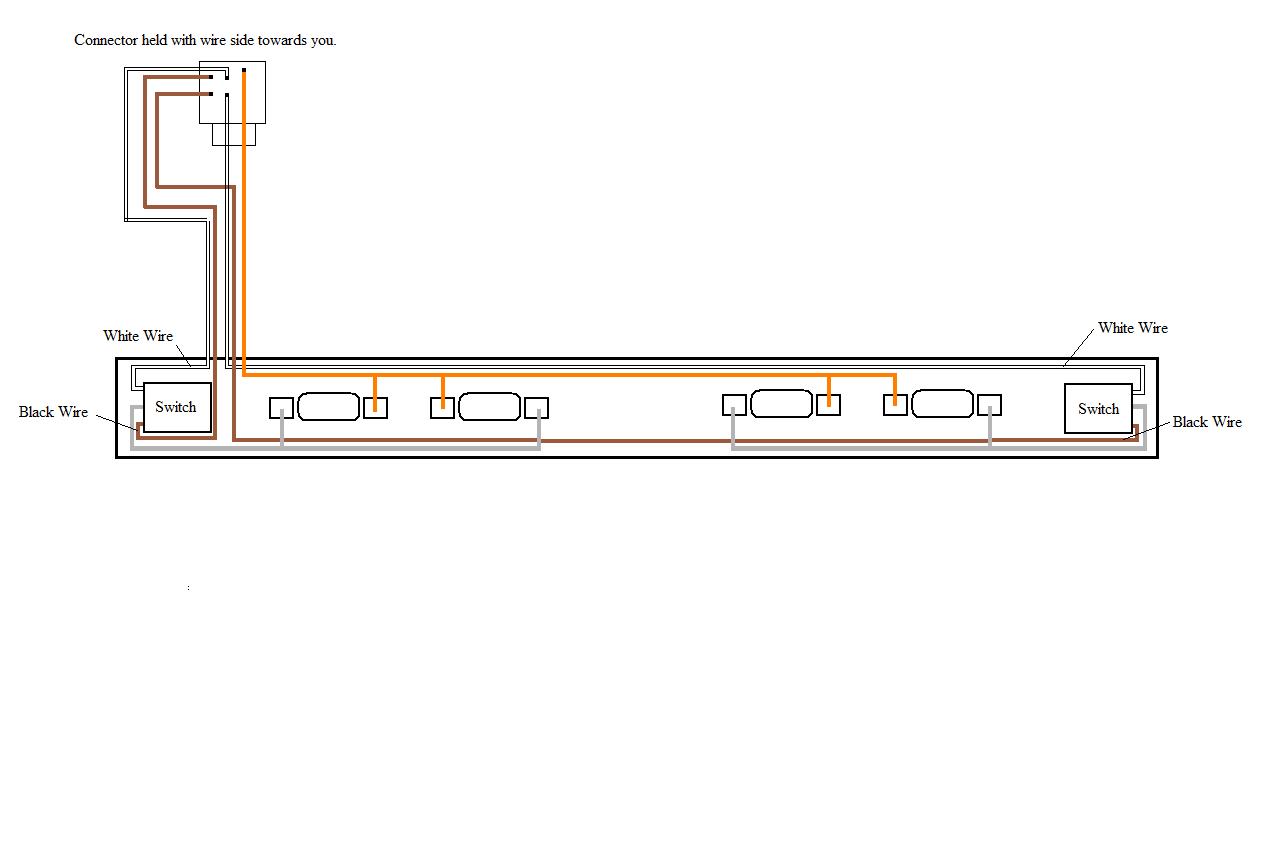

j_mezz Posted April 25, 2012 Report Posted April 25, 2012 (edited) My ears are ringing...I'm the one who's got the repro switches and LED bulbs. Just PM'd George back, if anyone else needs them let me know. To help with rewiring the incorrectly wired fixture here's a basic diagram of the wires on it... Edited April 25, 2012 by j_mezz Quote
George Posted April 26, 2012 Author Report Posted April 26, 2012 Thanx J_Mezz I will follow the diagram on install. Quote
